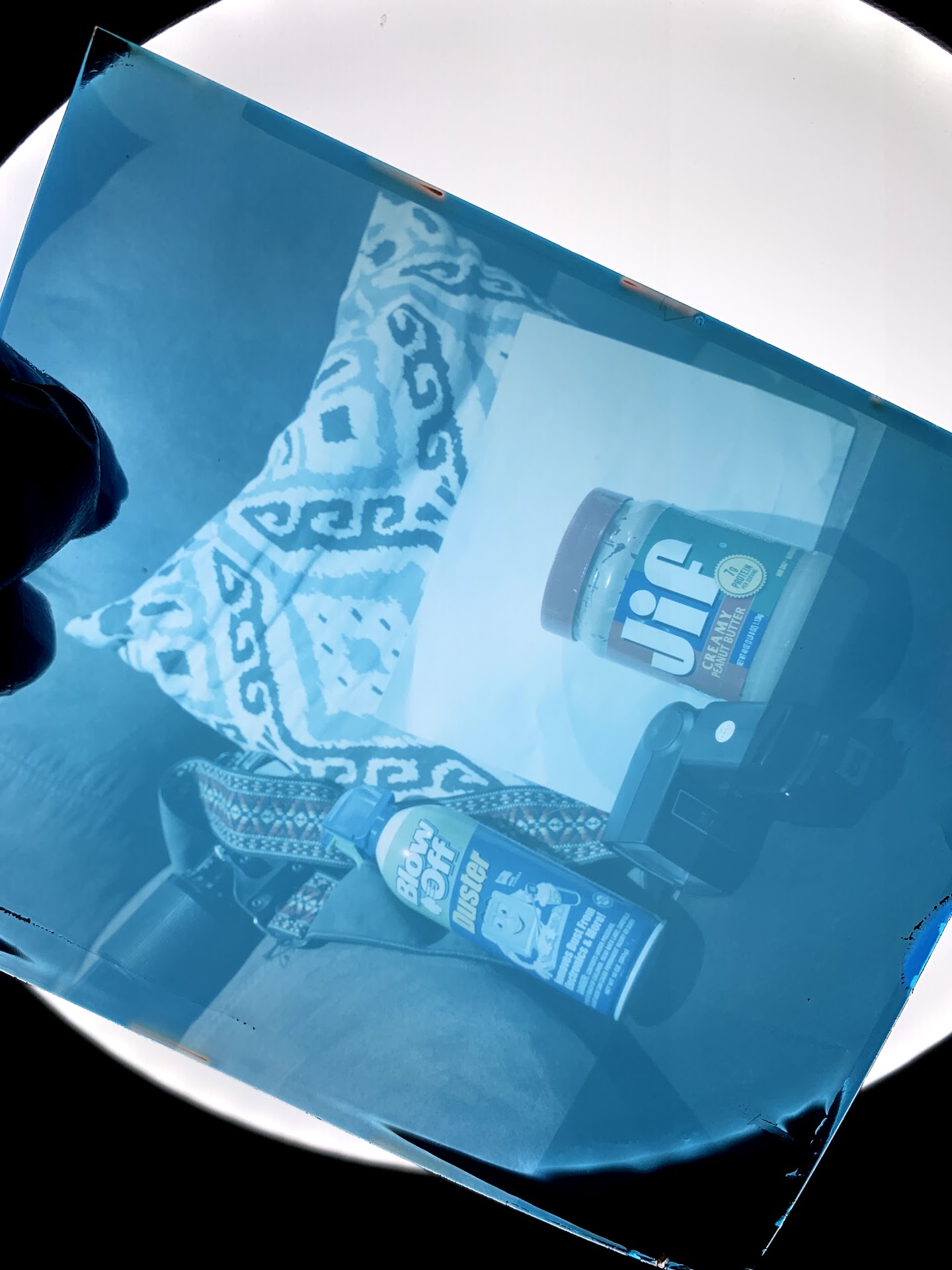

So I did some searching beforehand on photrio and basically only found questions of "if this possible" and "it was a proprietary process, it won't work"... Well I decided to try it anyway. The Anscochrome I have is probably some of the best kept stuff in the world. I bought a lot of expired film from an estate sale. Tons of different stuff including ansocchrome in a variety of formats. The person who I bought the film from told me he found it in the guy's fridge. Comparing it to the other B/W films, this definitely appears to be the case. So it's all "good" condition but not perfect. It doesn't appear it was all frozen, just kept cold and temperature controlled.
So I did a few preliminary tests on Anscochrome and found that the biggest caution is that the emulsion is extremely soft, especially when wet. Even when dry it can be deformed a bit by pushing on the film pretty hard. I also tested that it responded to C-41 developer by simply putting a strip of the 35mm in room temp C-41 for a few minutes followed by bleach and fix. C-41 will develop color on the film. Total stock is a few rolls of 35mm in 500 ASA, 1 35mm roll of duplicating film, 1 4x5 pack fo printon direct positive paper, 2 4x5 daylight films, 2 (1 opened) tungsten films. All films had an expiration date of between 1963-1967. The preopened tungsten is what I started with. The package doesn't actually have any speed or real directions other than saying that it needs a filter. The specific pack I used said it needed 05M. I ended up doing some research and found of all things a military photography document about the processing instructions and speed of these 4x5 sheet films. The daylight film is 32 ASA (reduced to 8 ASA under tungsten with filter) and the tungsten film is 25 ASA (20 ASA under daylight with filter). The processing time required is... intense. Temperature is to be 68F +/- 0.5F, throughout the entire process. Basic summary:
* First developer - 14m
* Stop
* Harden
* Wash
* Re-expose - 1m per side
* Color developer - 14m
* Harden
* Stop
* Wash
* Bleach - 5m
* Wash
* Fix - 4m
* Wash
* Final Rinse
The process was proprietary and in my searching I've not found any info at all about the process other than that it existed and these processing instructions. I couldn't find what color developing agent it used, potential agents of the first developer... anything. But I have a lot of film that is otherwise useless to me... So, I did a thing.
I shot 2 sheets of the tungsten film as a long-exposure under tungsten lights. One was shot at 25 ISO using a 30s exposure time, the other was with 1/4 of the film shot at ~50 ISO for 15s and the other portion of the film shot at 12 ISO for 60s. I also ignored the filter recommendation
Processing temperature was 70F (room temp) and all washing done with cold water from my tap (~60F). I used a spearman 4x5 developing tank and did agitation every 1 minute. My process was as follows:
* First developer - custom dilution of HC-110, 30ml of concentrate to 700ml of water - 13m
* Wash/water stop
* Re-expose, 1 minute per side (this emulsion strangely seems double sided!?)
* Color developer - Normal Kodak C-41 LORR working solution developer - 15m
* Wash/water stop
* Bleach - Fujihut C-41 bleach - 7m
* Wash
* Fix - Fujihut C-41 fix - 7m
* Wash
Amazingly, the results are proper kinda usable (with correction) color! The emulsion is marred some on the edges and is extremely fragile through every step of the process. Definitely only handle by edges and if you're really worried, don't have any of the important part of the image on the edges when taking a picture. The spearman tank system actually scratched the edges of the film due to how soft the emulsion is.
There is a very strong cyan shadow cast, but otherwise a visible representation of all colors. The results were fairly low contrast for slide film, but if I'm only developing this film to scan it, then what does that matter. I believe the cyan cast is primarily due to age fogging. During re-exposure, one side of the film was quite dark with fog and the other side seemed to have little or no fog. There was no eye-visible grain and red and green seems to be rather balanced despite the cyan cast. Because of the low contrast, both exposure levels produced decently usable results. The 50 ISO exposure didn't really cover enough of the subject to tell, but the 12 ISO shot looked to be the best. Whites also appeared to properly go to clear at 12 ISO with maybe a bit of cyan cast. A heavily fogged (I messed up loading the holder) sheet was also developed and came out with a very slight orange cast on the clear film.
Overall, the results are definitely exciting, even if most of the surviving film out there would be insane to process as reversal due to sub-par storage. I don't have a good proper way of scanning LF film so that's the primary reason I went with reversal. This film would likely produce reasonable and easier to correct results in C-41 negative developer, when done at low temperatures.

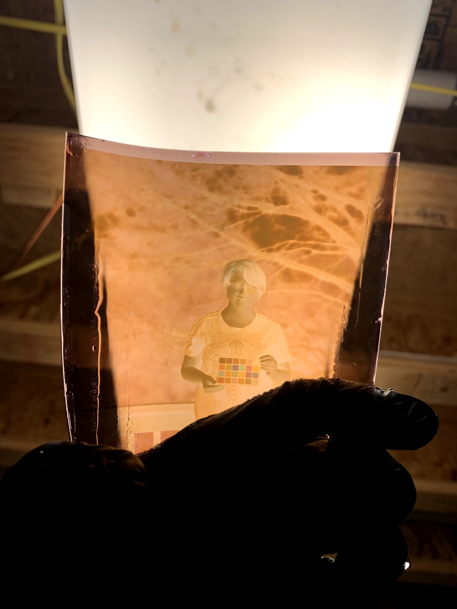

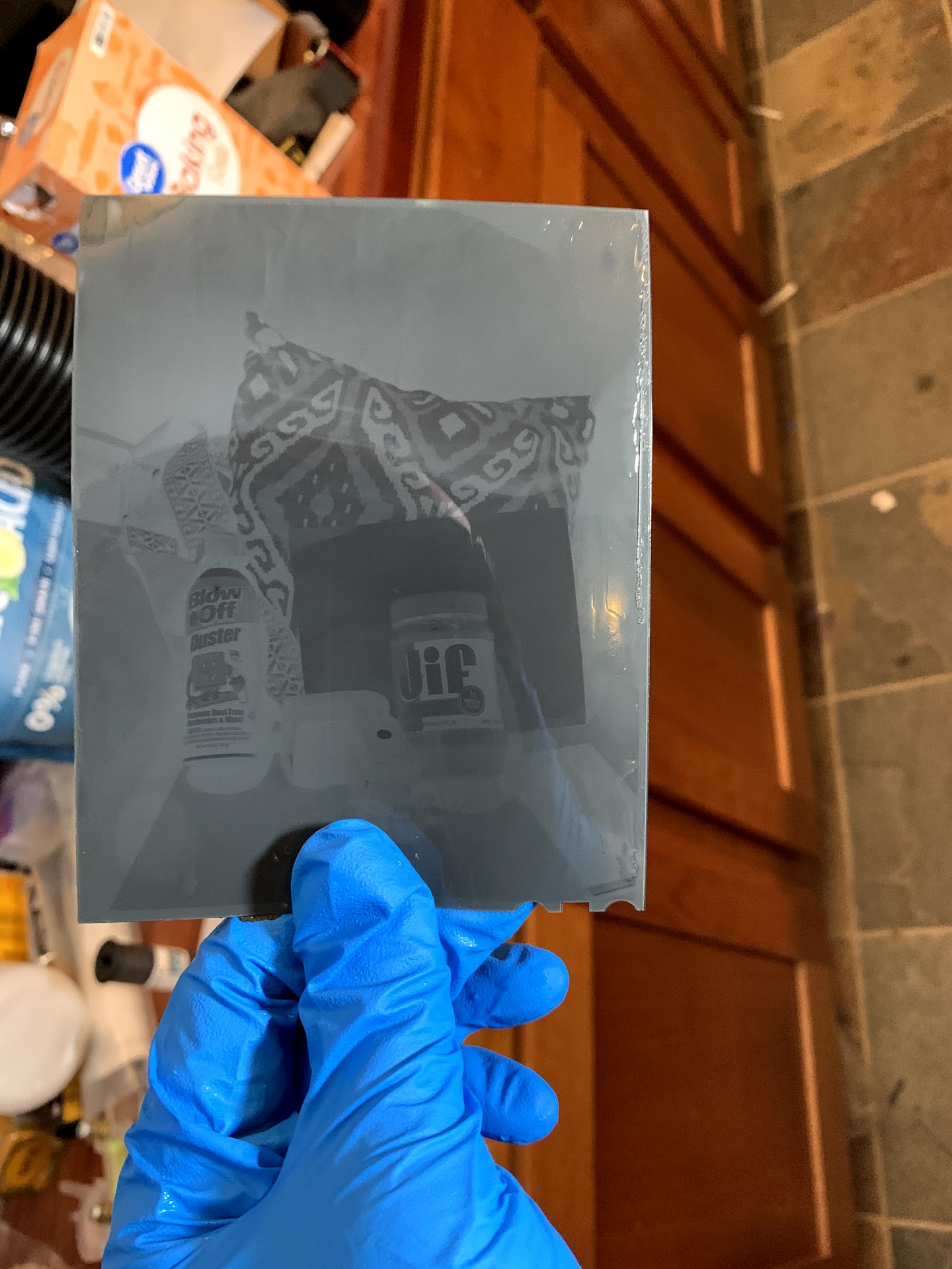

Attached pictures are a simple phone photo of the backside of the film during re-exposure (front side was too dark to really get a good picture of). The other picture is the final 12 ISO image on a daylight backlight

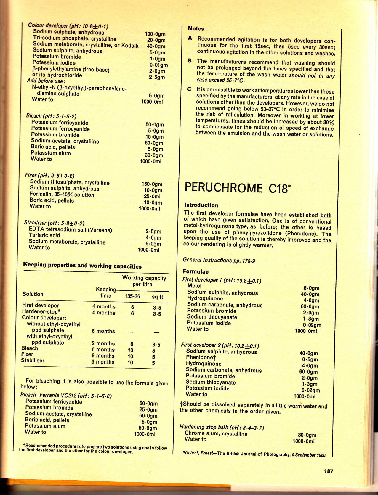

Very interesting and well done.

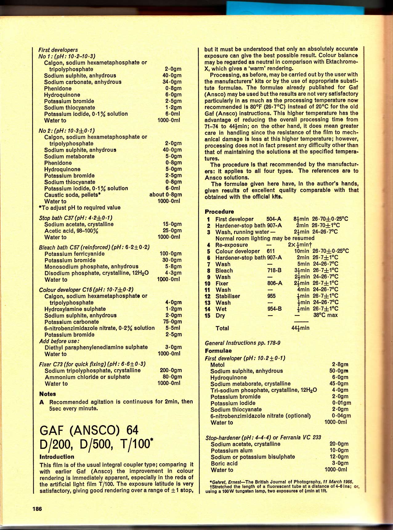

I found this in my BJP 1974 and hopefully it might help.
Looking forward to seeing more of your results.

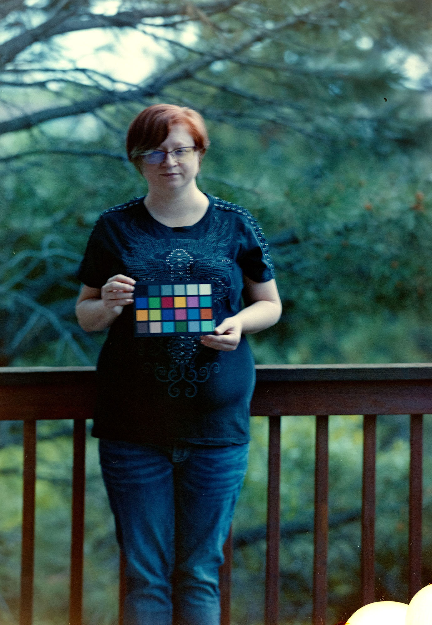

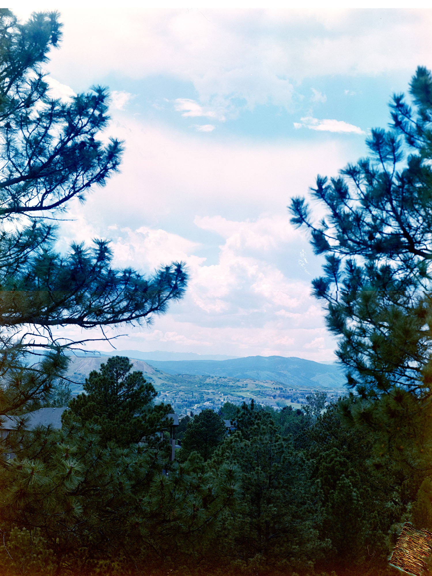

A few minutes in photoshop with a cropped scan (I can only scan ~1/2 of a 4x5 sheet in my DSLR setup) gave me this after correcting out the heavy cyan cast. Really not bad, but lacking quite a bit in saturation

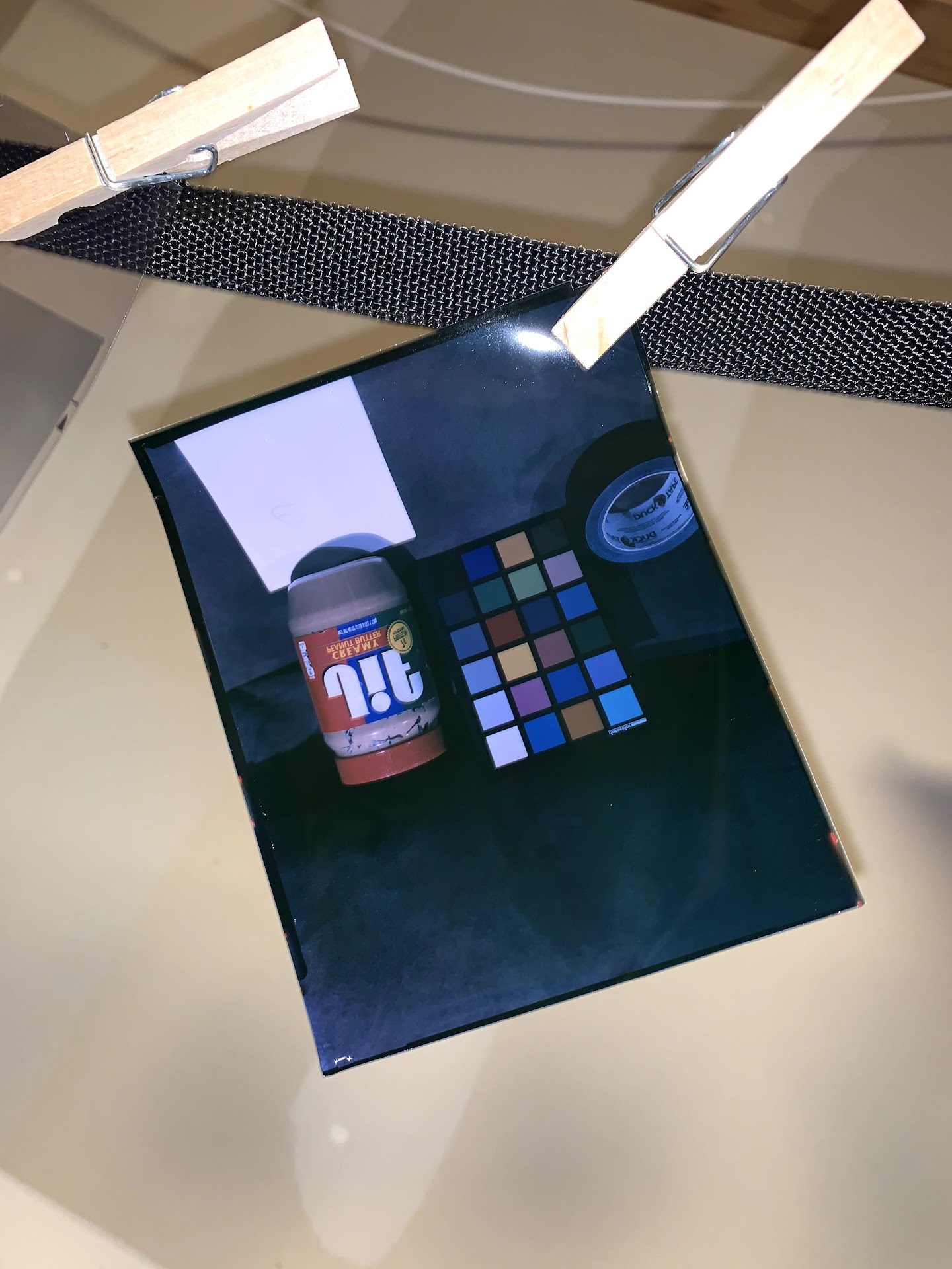

Given that the cast is actually visible in the B/W reversal development (ie, one side is very dark, other side is much lighter) I'm going to blame 90% of the cast on age fog and incorrect first developer formulation.
I did a new test run, primarily just tweaking the first developer. I wanted to effectively "pull" the film to maybe develop less fog, as well as use some additives like benzotriazole.
First developer formula:
* 30ml HC-110 concentrate (~A concentration)
* 0.4ml of 0.05% iodide
* 0.5g potassium bromide
* 2ml of 1% benzotriazole in 70:30 water/isopropyl alcohol
* 0.2g sodium thiocyanate
* top to 500ml with water. developing temperature ~69F, 10 minutes
The results are significantly improved, but as expected still quite far from perfect though. The highlights more properly cleared, and instead of a straight up cyan cast to the blacks, it is now a somewhat darker teal cast. Overall color balance is still cyan tilted, but to a significantly reduced extent. There is now some green cast there as well. Contrast is still sub-par, though that makes it have more exposure latitude so I'm not as concerned there.
More exciting than the film though is the results I got from some "Printon" Asncochrome direct color positive printing paper. I could find no info at all about speed, so I just took a guess and shot a sheet at 8 ISO and 4 ISO. The 4 ISO is definitely better but really needs another half stop or so. The results though are incredible. Proper clean whites, proper very dark blacks, mostly correct color balance with just a not too bad blue cast and very good color saturation. I didn't use any filtration and the filtration recommended on the box was 15M 15Y. The paper is also recommended for use at 3000K, rather than the standard tungsten 3200K. I think with the proper filtration this would actually give proper usable results at 3 ISO. The only color crossing I can see beyond the blue cast is a slight tilt to green in the dark shadows and greens in general being much less saturated than red or blue.
Results attached of the tungsten film shot at 8 ISO (with original run at the bottom for reference) and the paper shot at 4 ISO. Both using tungsten lights as long exposures and no filtration
edit: Also I believe that Anscochrome's color developer is closer to CD-4 than to CD-2. At least according to an old thread I found talking about similar non-American color developers. Apparently the agent used is a lower activity derivative of CD-4. So I believe that CD-4 is probably the best bet using modern available chemicals

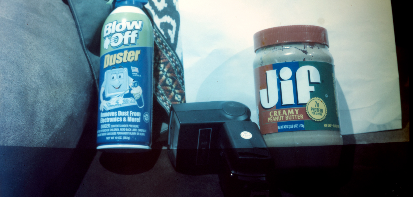

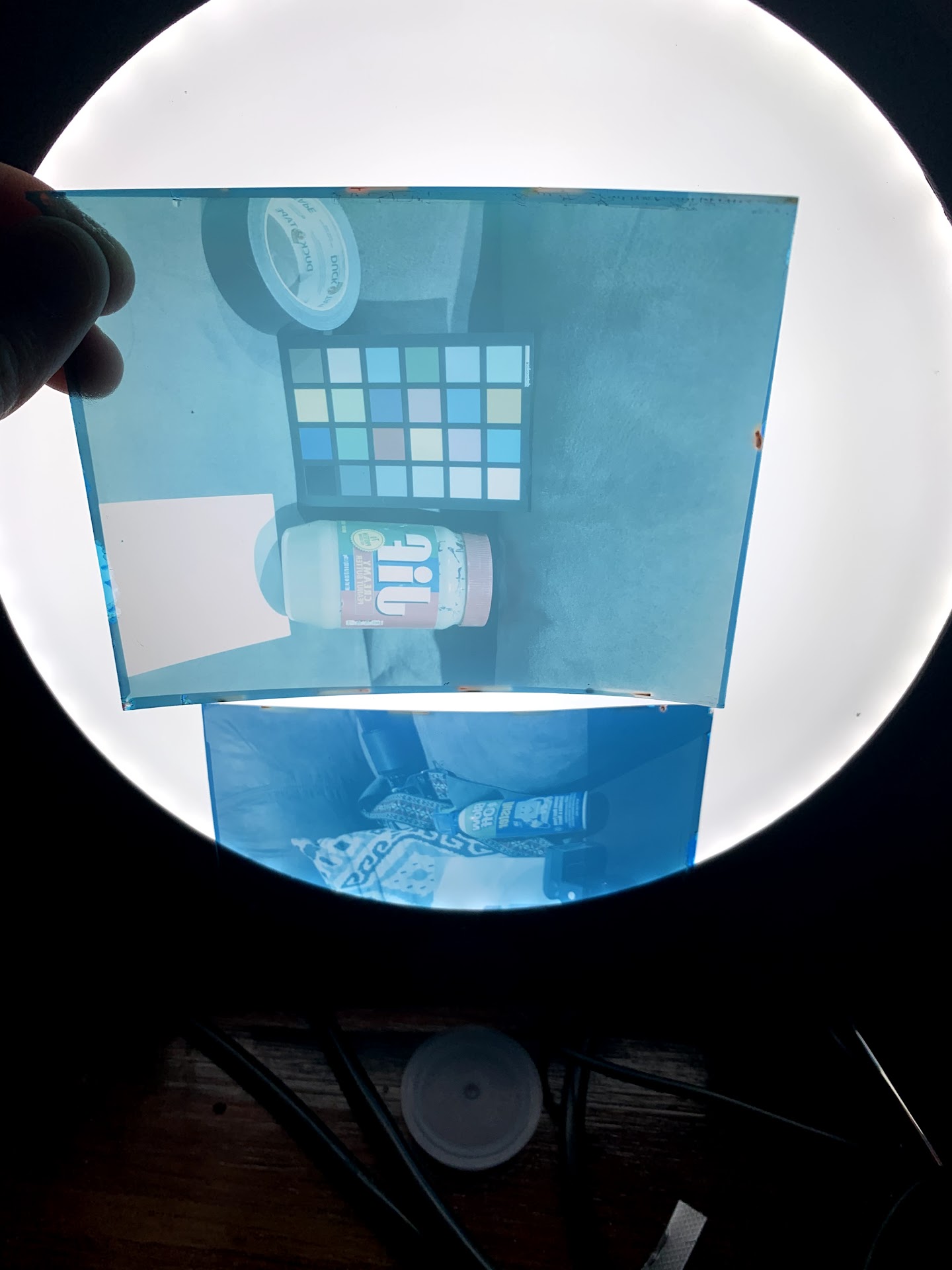

I tried this again using an approximation of the original first developer. Specifically I halved the amount of thiocyanate, increased iodide by 25%, substituted the metaborate with carbonate and borax, and substituted the antifog with benzotriazole. I know it's quite a bit of modification, but didn't want to order new stuff just for this or worry about how to designed a developer for this. The results were significantly worse than with HC-110. The thiocyanate especially brings out the fog level making the slides quite poor.
I also ended up mixing the bleach from the formula except for excluding the boric acid, acetate, and pot alum. I don't have any of those and really don't feel like it's a great idea to try to substitute them with my limited knowledge since acid+ferricyanide is something that requires caution. I tried redipping some of the previous slides in the bleach and this bleach definitely works better. It increased density slightly and added considerable more green to the very cyan casted slides. Far from usable, but an improvement.
However, I've had enough of wasting this precious film, so I decided to instead just do a straight up C-41 cross process as negative, but at room temp due to the super soft emulsion. Exact process:
* All at a room temp of ~70F with tap water temp of ~66F
* Pre-rinse for 2m (gives up a lot of blue dye)
* C-41 developer, 5m. Agitate 30s initially, then 30s per minute
* Rinse for 2m
* Custom ferri bleach, 5m
* Rinse for 4m (the bleach is pretty slow to rinse out, I still got yellow rinse water after 2m of rinsing)
* C-41 fix, 5m
* Rinse
I also over exposed for 1 and 2 stops (2 stop negative not shown). The results overall look under developed but still very good for a 1960s expiration color film cross processed using a process that didn't even exist at the time. Strikingly it looks exactly like a C-41 negative! I'm unsure how fogged the film truly is, but fog levels seem minimal here if the "mask" is an actual mask and not fog. The base is specifically an orange-ish magenta. Grey density is orange casted like a C-41 negative. All colors are represented. I don't have a good way of scanning 4x5 but will try to figure out something better than this makeshift job. Manual correction from a cell phone "scan" indicates there is definitely looking to be quite usable. Middle grey is a little bit blue, but this was taken under cloud cover so not too unexpected. Color vibrance otherwise looks pretty reasonable. The real test would be to try printing this to RA-4, but I'm happy enough if it scans well. The 2 stop test didn't include a color chart so hard to judge, but does seem this has a strong tendency to go blue in shadows. Either way, very excited to figure out a more proper way to scan this!

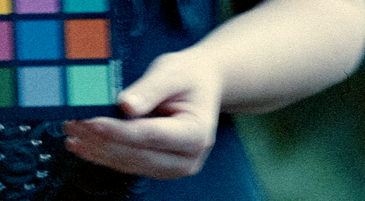

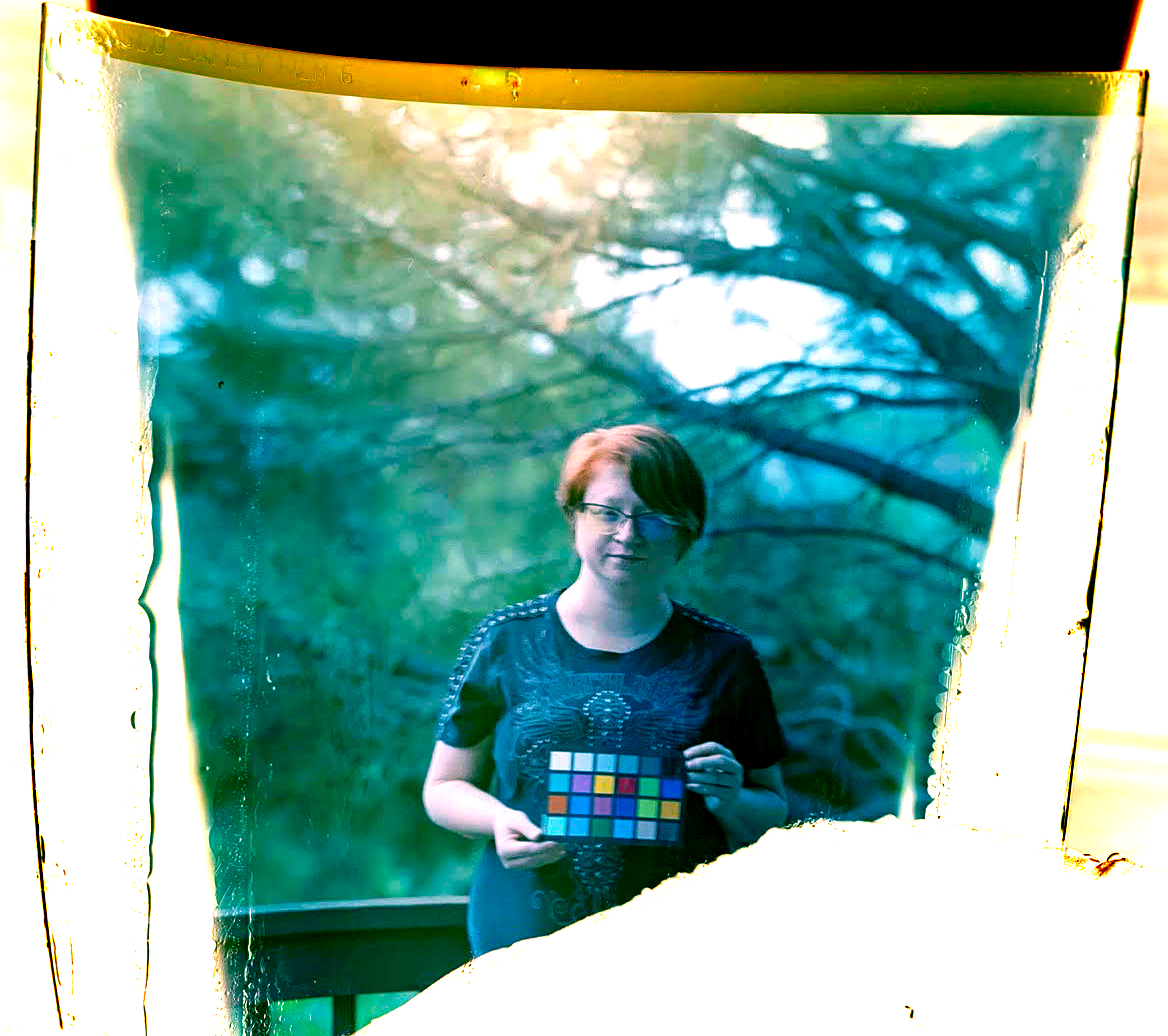

More properly scanned and processed images. Turned out very grainy! Even with 16MP scan resolution the grain can easily be resolved. The first image was stitched and the weird edge colors are due to scanning artifacts

I'd keep pH at or below 4.8 (see my Kodak F-5 comments) above.
I would agree for the Agfa/Ansco emulsions. Kodak bleaches are between 6.5 - 7.0 that I have seen. Jacobsons show 6.6-7.0 in the 72 edition, I'm sure that is from BJP but I don't have it. 25g of potassium nitrate will probably do to hold that pH. Jacobsons state that for AGFA CNS films the bleach pH is critical for cyan layer mask formations, while for kodak and 3m these occur in development. Thus, I assume, meaning pH is not as critical in Kodak as far as THIS is concerned, but that the Kodak formulations, at least in the C22/E-3/E-4 days would be the wrong formulation for Agfa, and I assume again, ANSCO.
If I understand this correctly the cyan layer, at the base is giving the reds, at least and this could be part of @earlz ' issue? He may need a more acidic bleach to form that mask than he gets from the Kodak bleach. If that is the case, we see some of the differences appear between Kodak and ANSCO with iodide, thiocyanide levels, pH issues in the process parts, and possibly benzyl alcohol issues. Ansco 1st developer according to Jacobsons/BJP 1971 has 10 (ml I assume) of potassium iodide solution in 1st dev vs Kodak E-3 0.0 and E-4 6.0.
Fun stuff.
Mike1A
Oct 30, 2020
17
Uintah UT USA
Sorry, reading over both sources, I think Glafkides agrees the bleach pH in ANSCO should be 4.5 to 4.7. Interesting that his formulae continuously leave out the bleach pHs in that sections :smile: However Jacobsons show CNS bleach around pH 6 for AGFA and reversal bleach around pH 5.0 and 5.4 for AGFA / ANSCO. 4.8 might be the lowest I would go, but I think Jacobsons (based on BJP) and BJP are often more from practical experience and perhaps Glafkides is closer to the chemistry. My round about way of saying Glafkides might be right-er.

That correction should also be noted about the stop bath above - ORWOColor 37 which, by the same chemistry/logic would not necessarily be hardening.
Acetate is a good buffer in the pH range between 3.7 and 5.6. It still works reasonably well at pH 6.5. It has no gelatin hardening properties to speak of, and the document @foc posted does not indicate any hardening property of ORWOColor 37.
PS: I don't have the Jacobson book, so my comments may be off.
Potassium Nitrate has no buffering properties in the pH range of interest to us. It is added to protect stainless steel tanks against corrosion. I have seen it (or Ammonium Nitrate) in E-6 bleach recipes as well.
There are different types of color couplers. Some need an extra oxidation step after the reaction with PPDox to form a visible dye, until then they are leuco dyes. Several ancient bleach patents address this issue. AFAIK modern film does not have this issue.
If @earlz results suffer from lack of leuco dye conversion, the answer is not stronger acid, but stronger oxidizer. This could be an issue, if he bleached with a weak Ferric EDTA bleach or BLIX. It is a very unlikely issue, if he bleaches with Ferricyanide or a modern, Ammonium Ferric PDTA based, C-41 bleach.

I bleached using ferricyanide and ferrocyanide, but without boric acid as was recommended (felt unsafe to add without more certainty... meanwhile I'm adding sulfuric acid to ferricyanide ECN-2 bleach heh). There is a difference in cyan dye formation that I can see with my bare eyes when doing a quick test dipping a half sheet of C-41 bleached and fixed film into this ferri based bleach, it causes more cyan dye formation even after fixing. This is why I used this bleach in my last run of this. I have 2 sheets of this to process eventually, but I will not developer in positive. It compromises any exposure latitude I have and I honestly believe the film is just too far gone to give good results in positive at this point. Even frozen, 60 year old film can only give so much, especially these known to be unstable early color formulas. I definitely don't plan on trying to source CD-32 or anything like that. If anything I could try processing in ECN-2 developer instead of C-41, but otherwise I'm content with my current process for my occasional need for a very vintage color vibe with the unique results given here. Specifically, it gives grain you can see with your bare eyes even on 4x5 contact prints, gives a green tilted image, and some color crossing with blue shadows and yellow highlights. It's pretty unlike anything else I could imagine shooting, but don't intend to waste more film trying to figure out a better process. I will however develop longer next time I do a run of this film. The results were definitely a bit thinner than they should've been, even if the results were usable with 2 stops of over exposure
@earlz Well experiments are always important. Sometimes with this more compromised film, I use it as B&W. Isn't QUITE as much fun, but I usually get pretty good results. I've learned something in the process at least! LOL.
