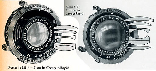

I have a Xenon on my Retina IIa. Is this Kodak's name for a Xenar? Regardless, I once did a direct comparison between this camera and a 50mm Summicron on my Leica M6 using a very sharp, fine-grain film and found the Retina to be, at least, as sharp in all cases and, maybe, just a tad bit sharper on some subjects. No complaints from me on how this camera performs.
Xenon is a double-gausss design, not Tessar. It's a very sharp lens.
Here is something interesting that I just found:
Thank you for the clarification and the link.
On the Kodak Retina, the 2,0/50 and the post-war 2,8/50 Xenon C are of double-gauss design, but the pre-war 2,8/50 Retina-Xenon is a five element Xenar, a Tessar design with an extra front element for better correction at this speed.

Schneider had their five element 2,8/50 and 2,8/75 Xenar in the pre-war years. It's unclear which cameras had the five element Xenar, but I don't think any of them had front element focusing.
The five element Xenar and the double-gauss Xenon:
https://live.staticflickr.com/5219/5471240392_e2cf8fea9e.jpg
Yes! Here is an interesting article on that topic, complete with a real nice photo oif Dr. Tronnier:
