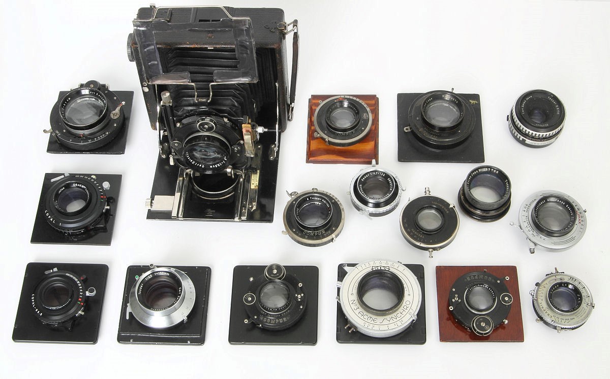

I have a love hate relationship with Tessar and type lenses, I have one or two others apart from those 50mm CZJ ones :D
In fact I have a few more than shown here, an Opton Tessar on an Automat, a couple of Raptars, another Ilex Parago, another 150mm Xenar an f4.5 that came with a MkVII MPP MicroTechnical, a 135mm f4,5 in a sunken mount. The most potentially valuable as it's a Zeiss Linhof 150mm f4.5 Tessar is the worst preformer despite bing in almost mint condition its just not remotely sharp, The rarest is a CZJ 165mm f5,3 Tessar, the best performers are the coated post WWII CZJ 150mm T f4.5 Tessarm and the late version 150mm f5.6 Xenar and the 210mm f6.3 Commercial Osaka (Congo). The Opton Tessar on the Rolleiflex is superb as well.

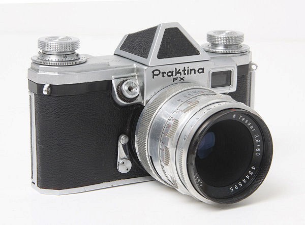

Twenty posts so far and no one stating to mount a Tessar on his 35mm SLR.
One of my first slr's was a Pentacon 35mm. I don't remember what model it was but it bore resemblance to a Praktica V with a body that was like an enlarged Contax. That did have a Tessar 50/2.8. It didn't last long! The mirror was the non instant return type and the mirror was returned to it's normal position for the next exposure by being pulled into place by a thin, possibly silk cord, dragging it down it back into place. The cord snapped where it as attached to the mirror and was irreparable. Or so I was told by a dealer who probably couldn't be bothered to arrange it.
Auto lenses were not fitted to cameras made in the early 60's (I had mine sometime around 1967/8) and the diaphragm of the Tessar had to be cocked by twisting a ring on the outside of the lens.
I also later had a Pentacon 6x6 medium format SLR and that too had a an 80/2.8 Tessar. In fact I don't think they fitted anything else as a standard lens. A lovely camera to use, but sadly lacking in reliability with constant wind on problems with usually overlapping frames. Eventually it got so bad, with some frames being almost 6x4.5 format. Then the next film would be perfect! That too was ditched when it got really bad.
I once had an Exacta, can't remember which one, which had a Tessar lens as standard, also one of my first cameras was a Prakrica, again can't remember which but this was early 60's which again had a tessar lens as standard
Yes I never had one with a Tessar, mine had a Pancolor F2, but they still crop up occasionally.
There was once called a Penta (or something very similar). Also from the old eastern Bloc. That had a Tessar and two interchangeable lenses. One was a 35mm and the other I think either a 85 or 135mm. I never owned one but I do remember the exterior design was 'different'. For different think ugly!
