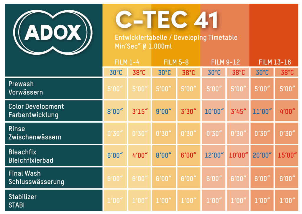

This is the chart. They say the developer can be used between 24 and 38 degrees as long as you compensate by increasing the developing time.
It looks from what you say above that Adox uses the same range of temps as the former Agfa C41 chemicals did It would seem unusual for a company like Adox not to test the results at the lower, 24C, end of the temp range each and if there were problems, to not say so in its instruction sheet
