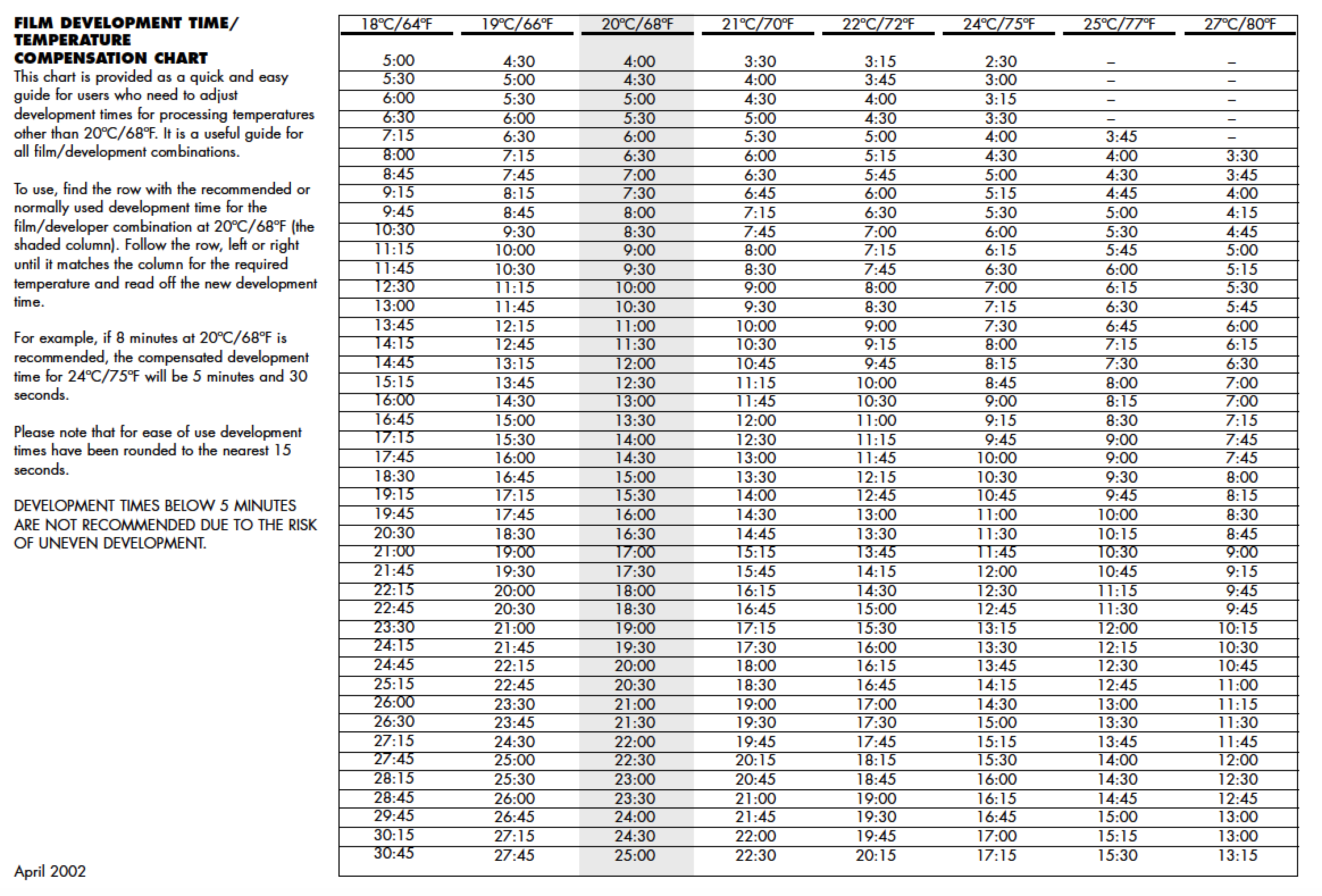

For those of you who are compensating for temperature, would you say that you're altering your development times similarly to the below chart, as provided by Ilford?
I use the "calculator dial" in the Kodak Darkroom Dataguides.
Which essentially does the same thing as the Ilford chart, but is more fun :smile:.
Yes! That’s a great chart. The compensating timers sort of have that built in
