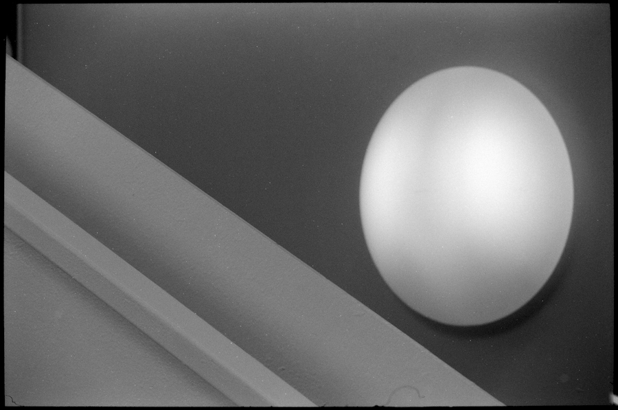

In my experience (with different – slower - speed films) that shift is huge. Look at this developing brief note as one example.
Kodak T-max 100 . Developer 104ºF (half time) resting after agitation in a hot bowl
1st Stop bath (water) 64ºF (continuos agitation for 1 +1/2 min)
2nd Stop bath (water) 104ºF (continuos agitation for 1 +1/2 min)
F
ixer 64ºF (doubling time) resting after agitation in a cold bowl
Here is the result
"Down the light"

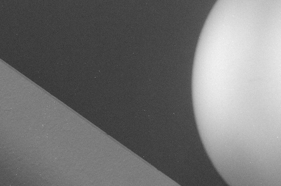

Nothing dramatic happened with such a difference in temperature. Hope you can see the detail, a few black (white) random spots spread all over
Detail
