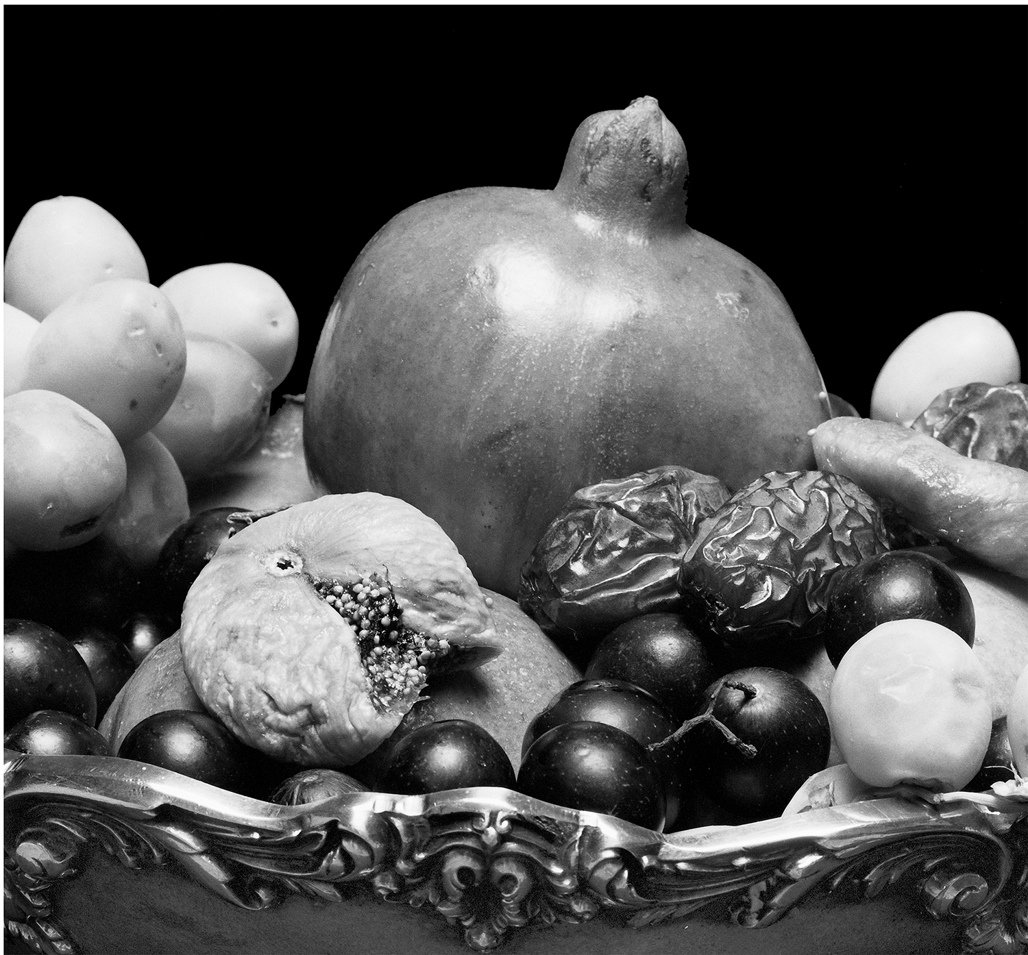

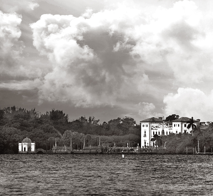

Here are two that I took to test the 2x and a support I had made by a machine shop to balance the camera , lens and 2x so the weight was even over a sturdy tripod.
the subject of the scenic was more than a mile away over the water. It is an old 350 that I bought at least twenty yrars ago (it was old then but the price was right an it was in like new condition).
