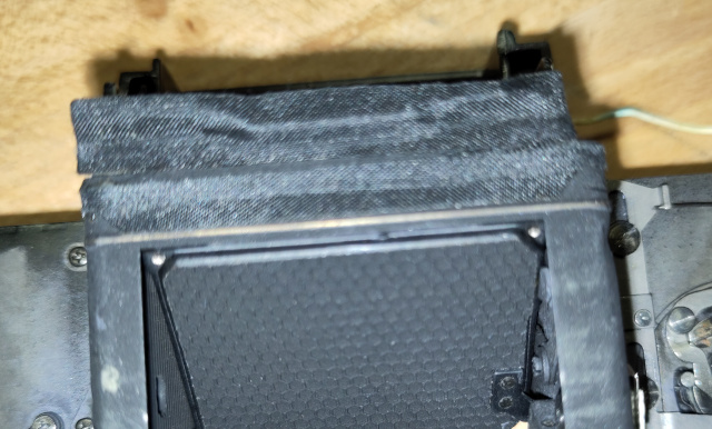

I'm currently restoring a F1 Old, and there is a light baffle at the back of the mirror box. I suppose the purpose is to shield the lightmeter from light coming through the eyepiece.
This is falling to pieces, and I'm wondering what could replace it. Microtools sells material for shutter curtains so that would be my choice, but I'd appreciate a reality check.

Laurent,
Sounds like you might need to replace the light seal foam. We get it from B&H and they get it from Japan Hobby Tool. You'd probably need to get a thicker foam and one that has adhesive backing. You can scrape out the old degraded foam, clean it up then replace with the new foam. Regarding the tool to align prism rails, You may not want to get in there and do any adjustments... as it becomes quite technical.

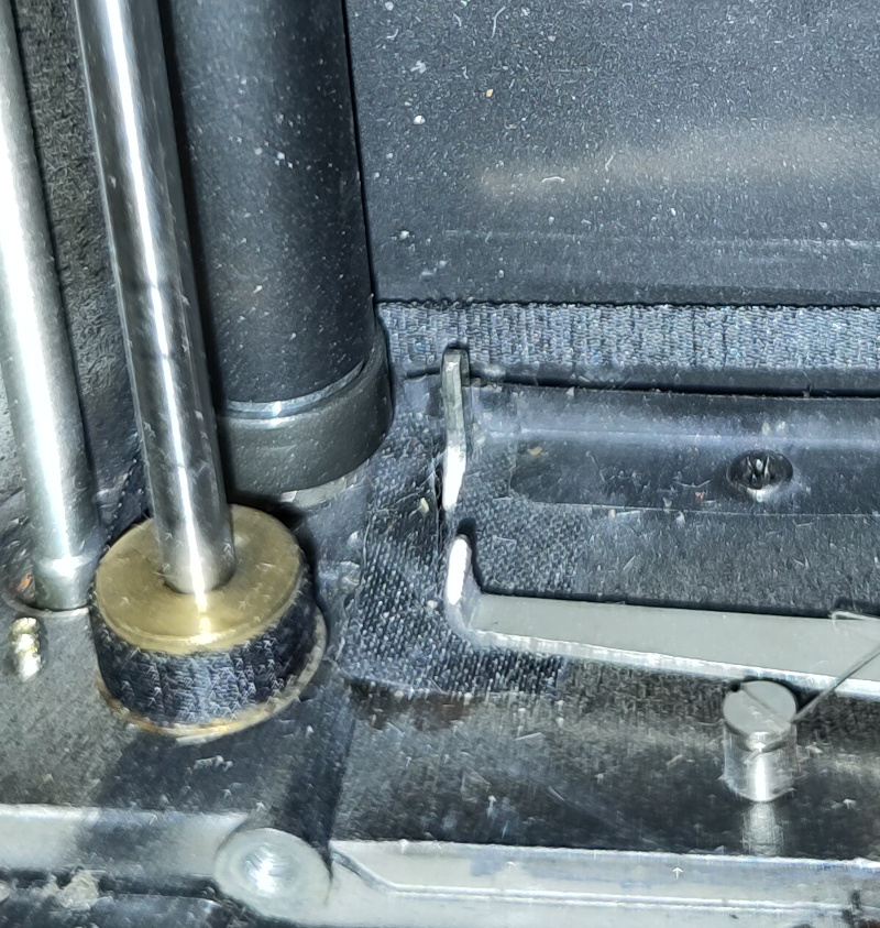

Thanks Kurt!
My question about adjusting the prism rails is about putting the rails back in place. I'll try to see how it goeswith no tools, otherwise I plan on 3D printing some kind of "body cap" to protect the screen, this may help. I'll make something that goes well on my other F1.
The other issue is not about light seal foam, but a piece of adhesive cloth that sits at the back of the mirror box and isolates (I think) the CdS cell from the finder. There is a similar material at the bottom of the mirror cage, it shields a lever.
