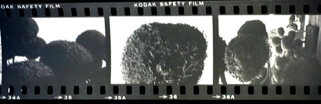

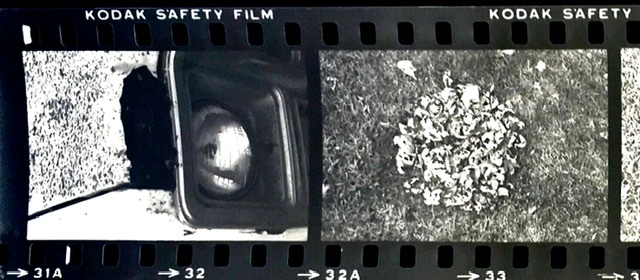

Tested Tech Pan shot at EI 200 and developed by infrared inspection in D-76 stock. 68-degrees F.
I talked myself out of snatching the film at 17:00 when the shots looked good. But talked myself into thinking that the highlights would be hard to print so I yanked the film out at 18:20.
It still was not long enough in the developer. 20 or 24 minutes might be better.

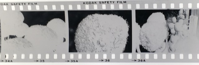

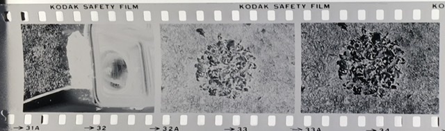

Oh yes. 64 minutes makes rich dense negatives at 200
Tech Pan exposed at EI 200 and developed in stock D-76 68-degrees F for 64 minutes.
These are just phone photos of wet negatives as-is and then inverted so you can see what might be possible. Skies are hopelessly blocked but the effect may be pleasing.
