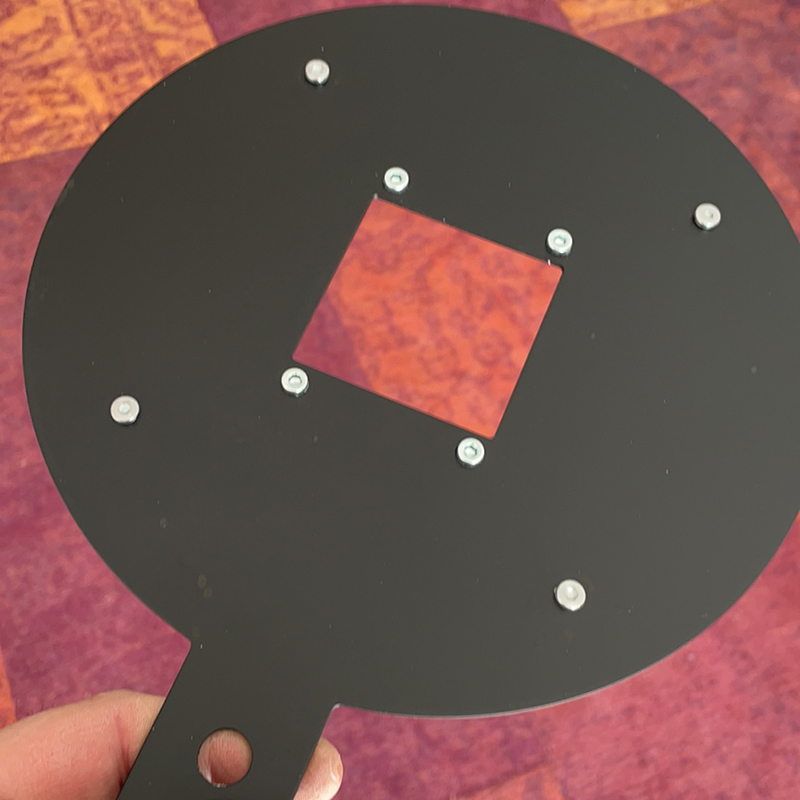

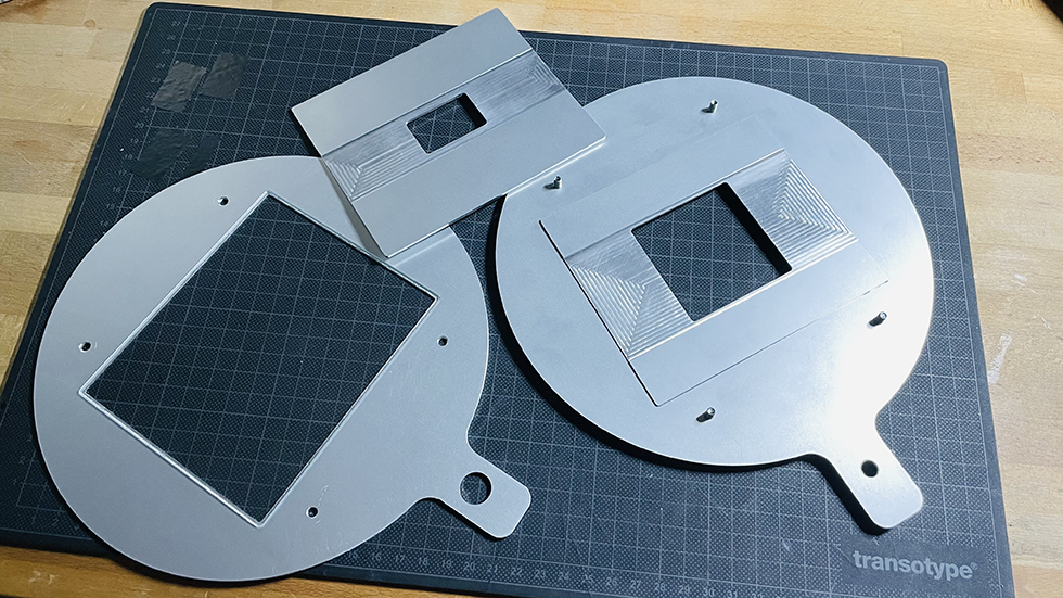

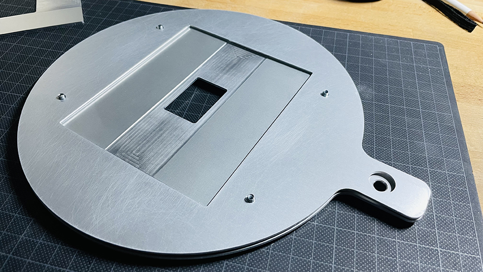

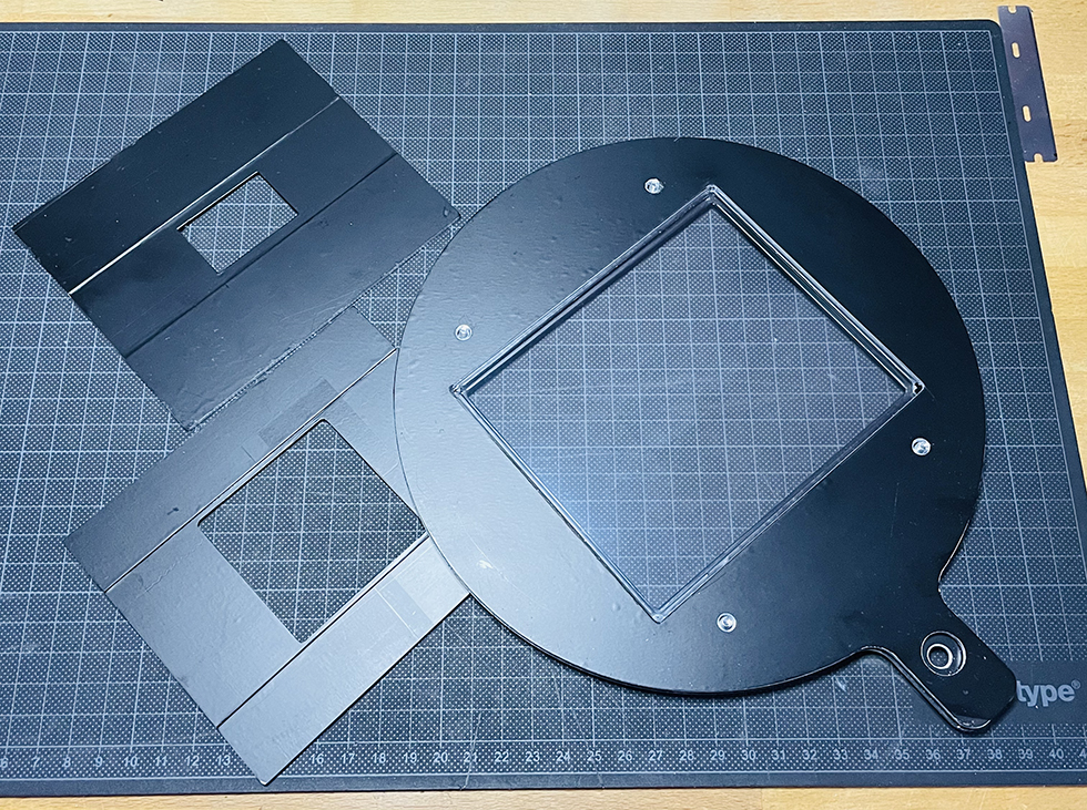

@lachlan Yup. After careful consideration I think I'll build my own. I already made a negative carrier for full frame Hasselblad printing.
I see a 504 in my future at some point. The 45MXT isn't a bad plateforme and I added an Heiland LED head to it.
oliton
Feb 1, 2017
17
Lux
And done.
Now I can print 24x36, 6x6 and 4x5 full frame (with film borders).
I can easily add a 6x7/6/9 insert.
Top glass is AN. Clear bottom.
