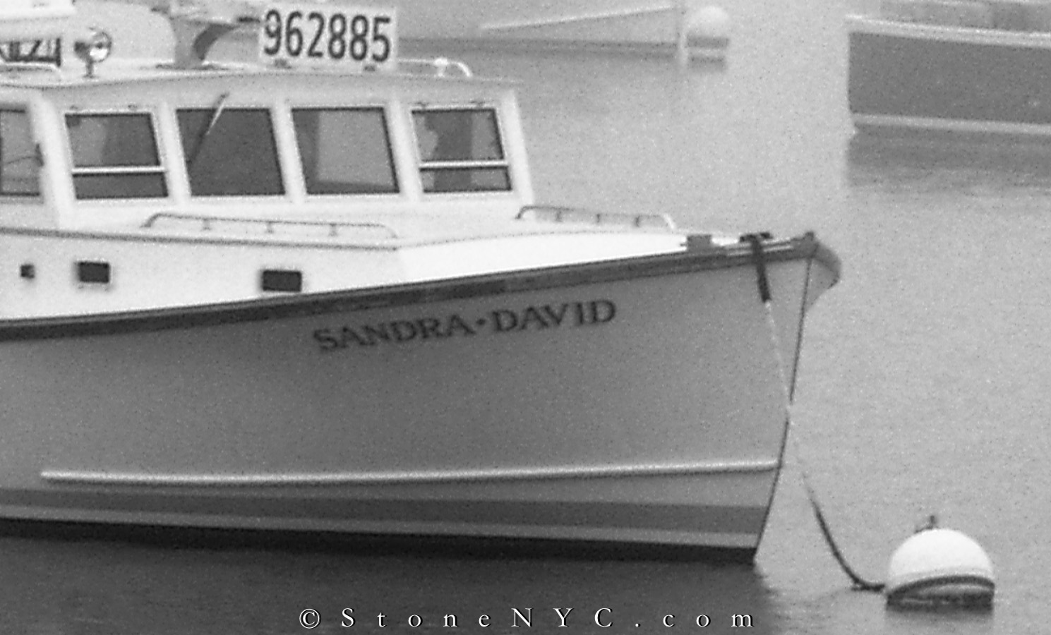

Hey guys, I searched the forums but couldn't find any recent threads pertaining to my questions.
SO
I've had a stash of tech pan for a while now, frozen in my freezer, and packets of Technidol. So I finally got around to developing one of the rolls I shot at Acadia National Park. Problem is, it doesn't seem sharp/fine grained at all, it's kind of ... "mucky"

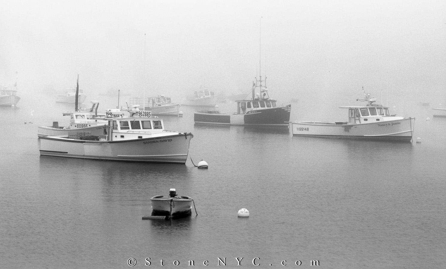

Here's an example...
Regular image
100% crop at 3200 dpi

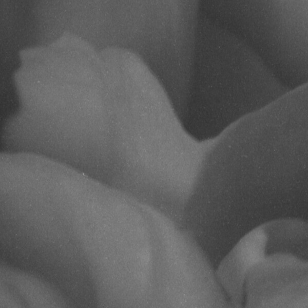

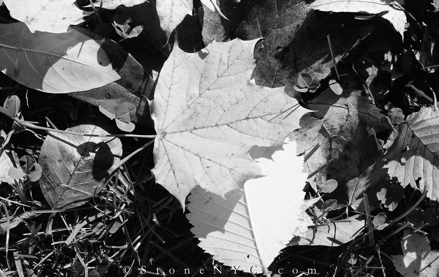

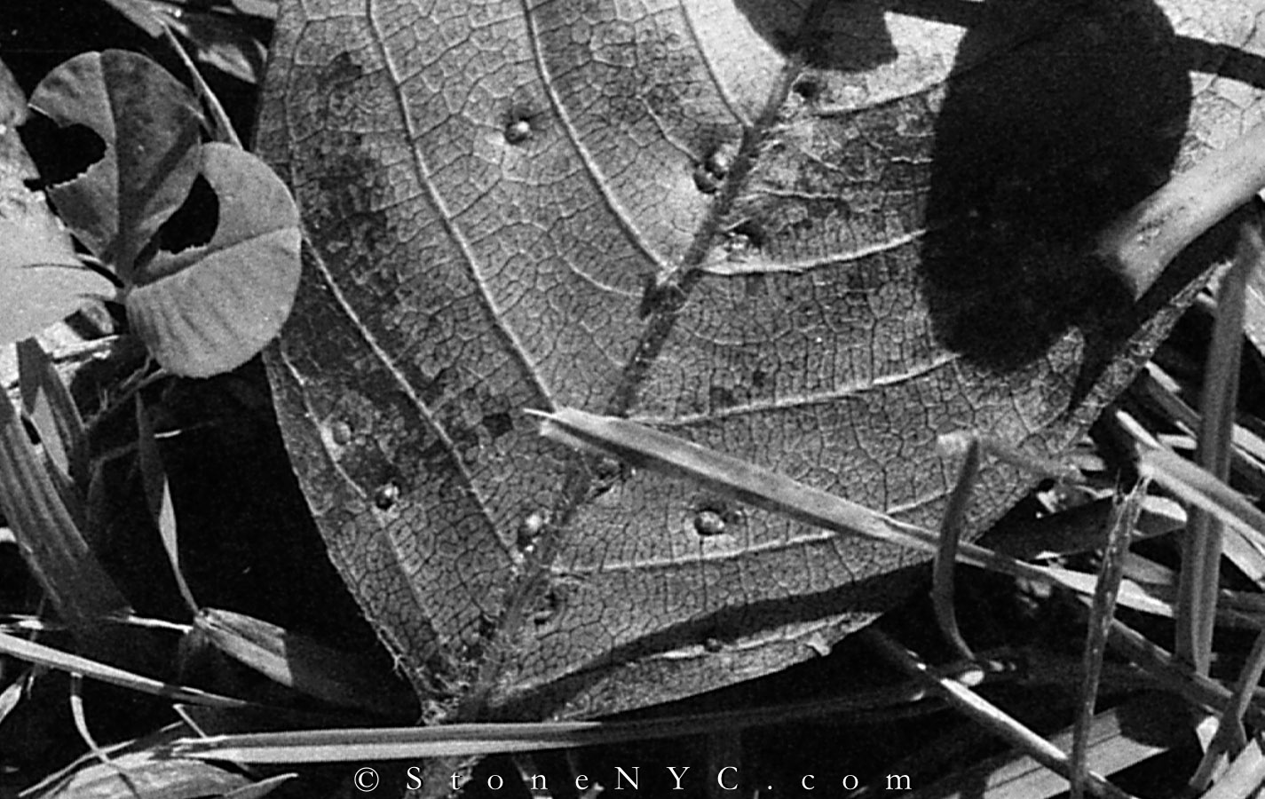

Now, as a comparison of something that is fine grained TMX (Tmax100) and developed in Rodinal 1:50 which though fine grained film, the developer shouldn't look finer than the tech pan...
full image...
So as you can see, even the stuff souped in Rodinal is much less mucky..... same scanner, same film holder etc.
I know what you're going to say "print it" but I can't, and still, it should be at least sharper than that even scanned no?
I followed all the instructions for the tech pan and technidol to the letter except ONE thing, and that's that I couldn't DROP the tech pan in because I only have a daylight tank, but it was only 1 roll so the 250ml of dev all went in within 2 seconds and I shook vigorously immediately like it says, then every 30 seconds.
Anyway, the agitation scheme seems crazy to me because it goes against everything I've learned about NOT having grain, but I followed it anyway.
So... what did I do wrong?

Yeah, print it. You might be looking at grain aliasing, which is an effect that occurs when there is significant image information at frequencies higher than the scanner's sample-pitch and the scanner lacks a low-pass filter. It's unlikely to be a problem with a flatbed since they're so soft, but some (usually) better scanners can show the effect.
More likely I think is reticulation. What's your temperature control like? Is it possible you overdeveloped?
I've attached a 4000dpi scan (Nikon 8000) of ancient TP developed in C41 at 20C. It's soft because the image is soft anyway (1:1 macro, not enough DOF, a bit of camera shake, low contrast scene and development, etc), but it doesn't have the crazy grain you're seeing. A definite speckle that I put down to the film being ancient and/or dirty, but not reticulated or anything.

The examples are of different subjects in different light, which might account for much of the different appearance. The few untextured medium grey areas in each example look much alike. Also, scanning at a mere 3200 ppi shouldn't bring out the best in Tech Pan.
winger
Jan 13, 2005
3,975
southwest PA
I agree with Jim - you're comparing a very low contrast shot to a much higher contrast one here. I honestly don't see horrible grain in the tech pan one - it looks more like the scanner blobbed grains together than like the film itself is grainy. Does that make sense? And, to me, the TMax one looks grainier.
I really wish I was in PA and could print this for you to see how it looks "for real."
FWIW, I like the harbor shot.

Thanks guys, I guess I'll just have to wait until someone can print it for me, some of the images were denser than I had expected, but I was very specific about temperature and agitation because of the instruction. There's one image in particular that looks as if it was not properly developed and yet all the other ones look fine, and what I mean by that is that the sky and all of the fog is on even in a very extreme "streaky-ish" way, but all the other fog images look fine, so it is possible that the sun broke through and was actually just causing some brighter and darker spots it was a really intense day, and since it's only on that one image, I hesitate to think that I had uneven development or anything like that,
I suppose I could mail the negatives to someone and they can print them at a very high enlargement. My understanding is that a 35mm image on tech pan could be printed as large as a 4 x 5 and still actually retain more detail. Not sure if that made sense what I mean is that if you used a 4 x 5 of regular film, and a 35mm of Tech Pan, you could print both at say 4' x 5' image and the tech pan would have more detail than the 4 x 5. So I guess I was surprised at all the Mc, it is possible that like you said the green is being grouped together and causing it to look like muck in the scanner, I use the Epson V750 Pro. For the 35mm I use the standard holders, I never invested in the better scanning holders, however I've basically dialed in the 35mm to the right height for the scanner and all the other stuff comes out decently.
Of course I also did check to see that the film was flat enough etc. it's not really that curly of a film so it's at the same height as everything else and also the base is completely clear, it's as if it's brand new tech pan, I've never seen anything quite as clear in older film, it kind of amazes me.
