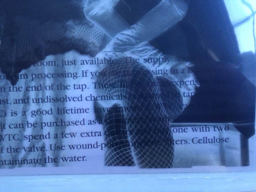

Wait so to clarify, it looks as if the OPD took a picture of the film with the newspaper on top of a lightbox, which would not be ambient light, so you're saying that you shouldn't put it on a lightbox and instead should just have it on a non lit surface and try to view the image through the negative?
This is not newsprint, however it's text which I think is good enough? In this example, the legs of the subject, are those overexpose because you can't easily read the text? or would this be proper exposure because you can just faintly read the text? Just clarifying...

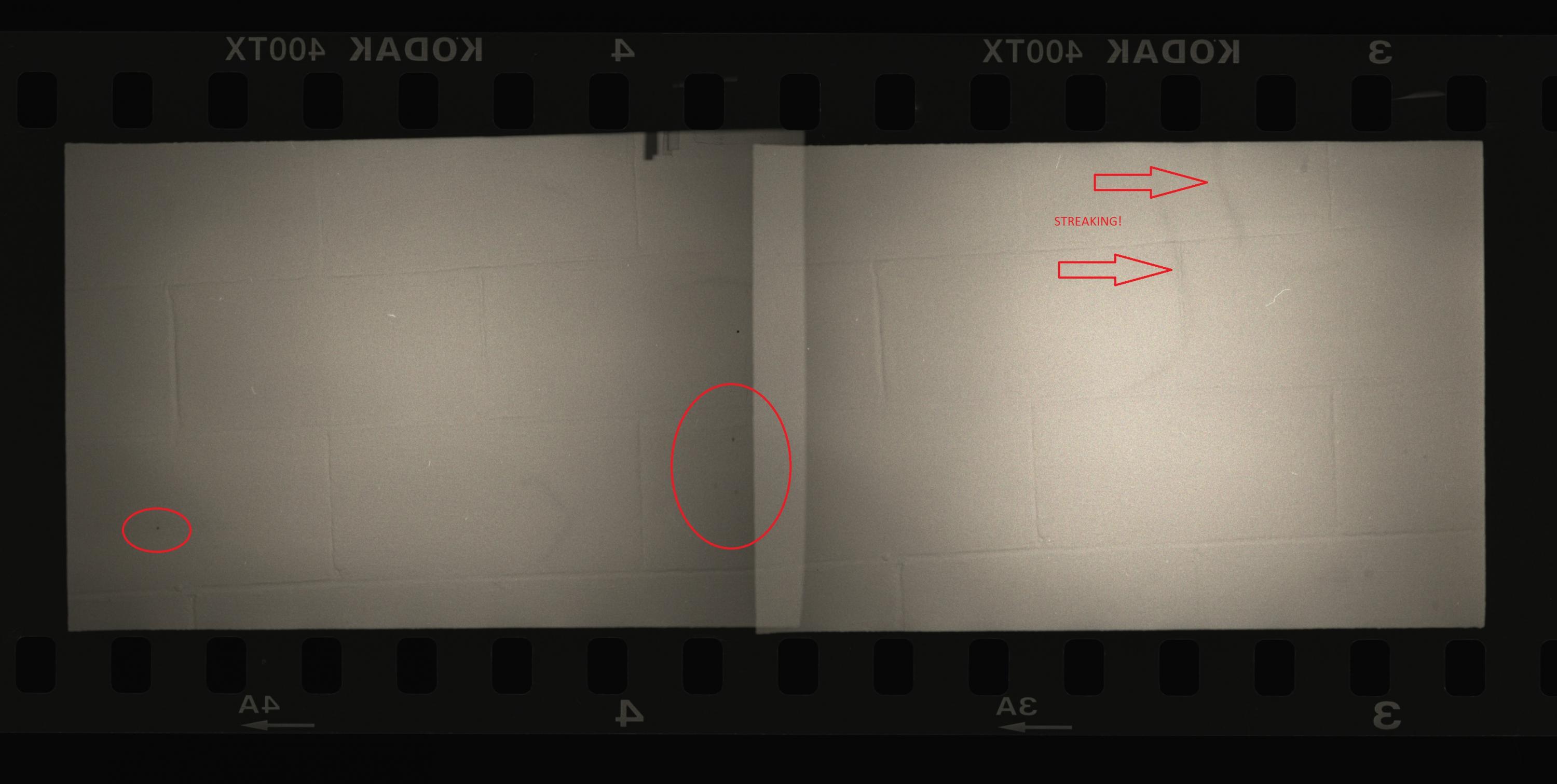

The holding tray of the scanner hides the edges, hence can't see the numbers on the negative.
Cheers
Raffay
Yeah, but you can see them in person.

Hi,
Here is another shot, same place/time. Exposed a little more and developed for three more minutes. The new neg on the left seems more dense to me.

A milky or foggy negative can be because it's not been fixed enough. I've had this problem before. If you think this might be the case, try re-fixing and re-washing a piece of the film in fresh fixer and see if it makes any difference.
Stone:
You are probably doing it right here. My only caveat is that the reason newspapers are/were prescribed for the test is that the text wasn't as dark and the paper wasn't as bright as one would find in some books. In other words, the test was designed with a relatively low contrast target.
And as for the negative itself:
1) it figures that you need to assess negatives with lots of women's legs in them :whistling:;
2) with a little bit of work, you can read text through the dense area of the negative, so if it isn't right, at least it isn't far wrong;
3) if the representation on my screen is accurate, I would probably reduce development a bit. But that may be a matter of preference, rather than requirement.
I've posted this link before, and the important table in it isn't perfect, but it does organize the information well: http://www.ephotozine.com/article/assessing-negatives-4682

Of course :wink:
Though I promised the model not to show the top half, it's a little more "showey" lol.
It also shouldn't surprise you that I didn't fully read that article, but I saved the picture to my phone, as a reference point it's really nice! I hope the OP can use it as well.
And I actually figured as much when it comes to newspaper print that the papers a little yellower, and the print is a little thinner, and wouldn't be quite as contrasty as regular book print, but I was too lazy to walk downstairs to get a newspaper :wink:
