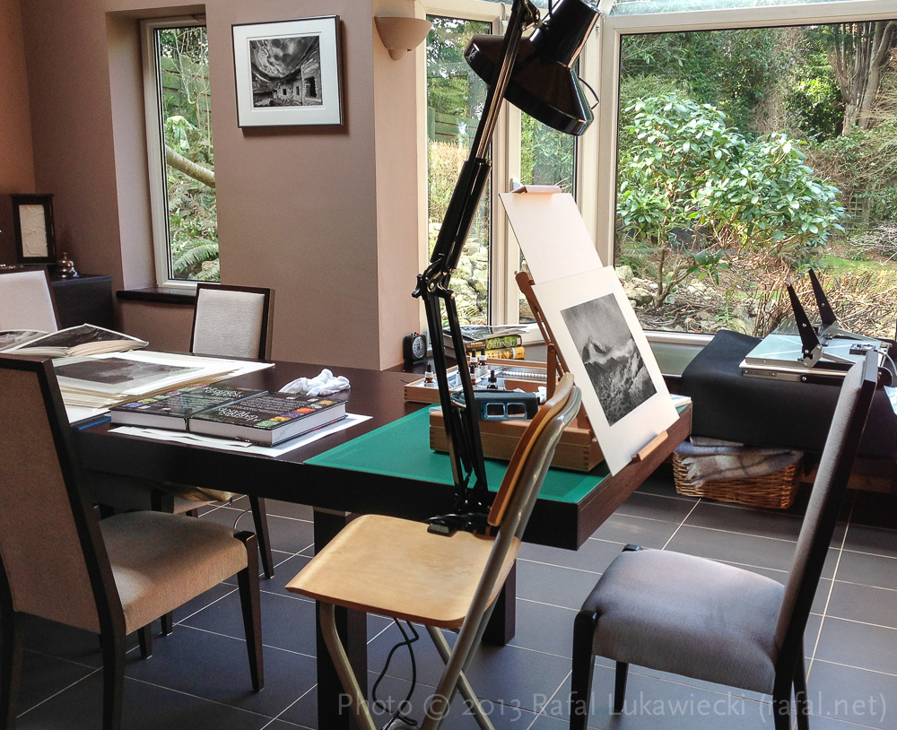

I've been using Spotone in the past, earlier Marshall, and recently the Diaphoto dyes. Spotone had the best colour match to the papers I use, nowadays mainly Se toned MGWT, and I am still not 100% there in terms of the colour match with Diaphoto, but getting there. John Sexton, with whom I had the pleasure of studying a couple of times, currently uses Peerless, mixing their Lamp Black, Ivory Black, Spotting Black and Pearl Grey dyes, as needed. The technique he, and even more so, Anne Larsen, showed, relies on the use of almost dry Winsor and Newton Series 7, size 000 and 00 brushes, in a stippling motion, starting at the centre of a spot, and working in a spiral towards the edges. An OptiVisor No 5, plus an easel, and a good source of light, preferably mixing daylight, tungsten and CFL if possible, make the job much easier. For what it is worth, here is my spotting set-up:

Thank you, Rafal, this is most helpful.
