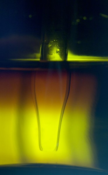

I mixed up some Instant Mytol in organic solvents (TEA and PG) a couple of months ago. (there was a url link here which no longer exists) Here's what it looks like now:
It's turned yellow, with a red haze along the top. Red! I noticed this after 7 weeks, but I hadn't been looking before that. This concentrate has been in a stoppered glass bottle the entire time. I also have some concentrate that's two weeks old of a different formula that contains no TEA, and it's still clear. The other ingredients are the same, making me wonder if TEA is destroying something else in the brew.
Any idea what's happening?

It looks like oxidation to me. When you say stoppered do you mean you are not using a screw cap? I can't tell from the picture.
I meant a screw cap. This is an amber bottle sold by the Formulary, the kind that has a built-in dropper. The cap has a rubber seal.

TEA being alkaline will hasten oxidation. However it looks worse than it actually is because the oxidation products are dark in color. Once the oxygen at the top of the bottle is exhausted it will stop. I doubt you will find any noticeable change in activity.
I would not use a cap with a dropper as it may leak air into the bottle more easily that a regular cap.
