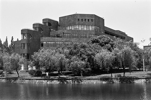

This is with a 5 element lens P&S camera on Spur Ultra R 800 at EI=25:
Great results. Would it also work with Agfa Copex Rapid?

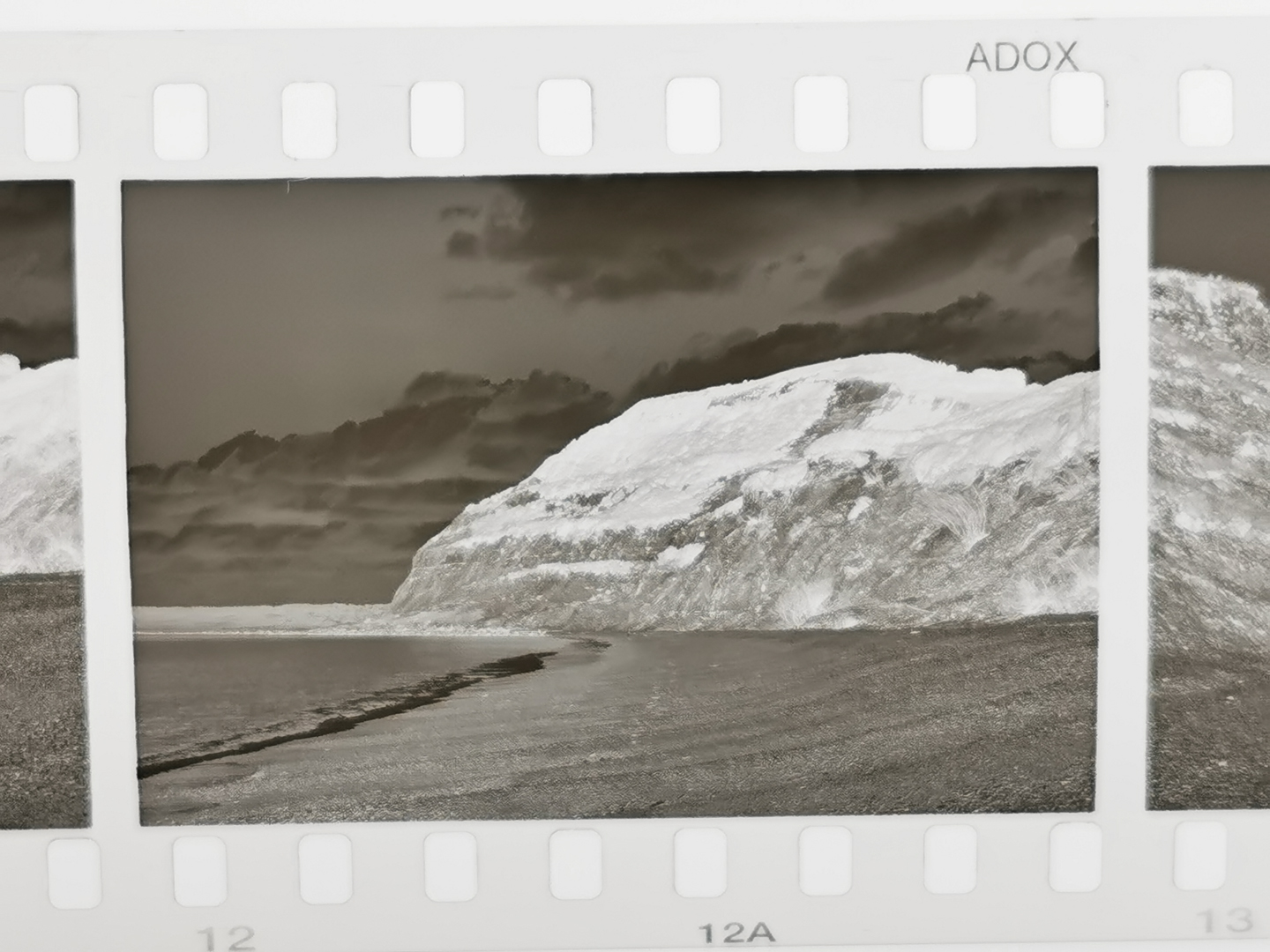

Wow, the CMS20 shot is really a nice one.
Which EI did you shoot it at? Can you post the negative so that we can have a reference point?
I was lucky to get ideal conditions with sun and cloud, not too contrasty, easy to process.
Shot was on Adox CMS20 II at EI=20, Canon EOS 10, evaluative metering.
Phone pic of the negative is attached, it is actually less sepia than appears here.

Really a great shot and nice negative. Thank you!
