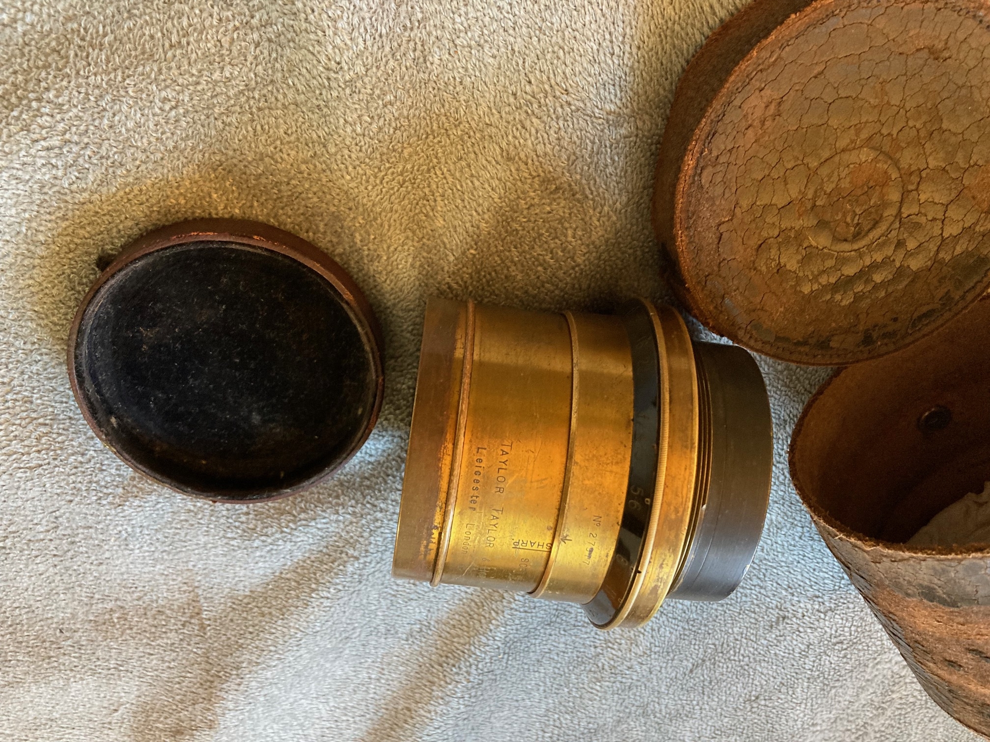

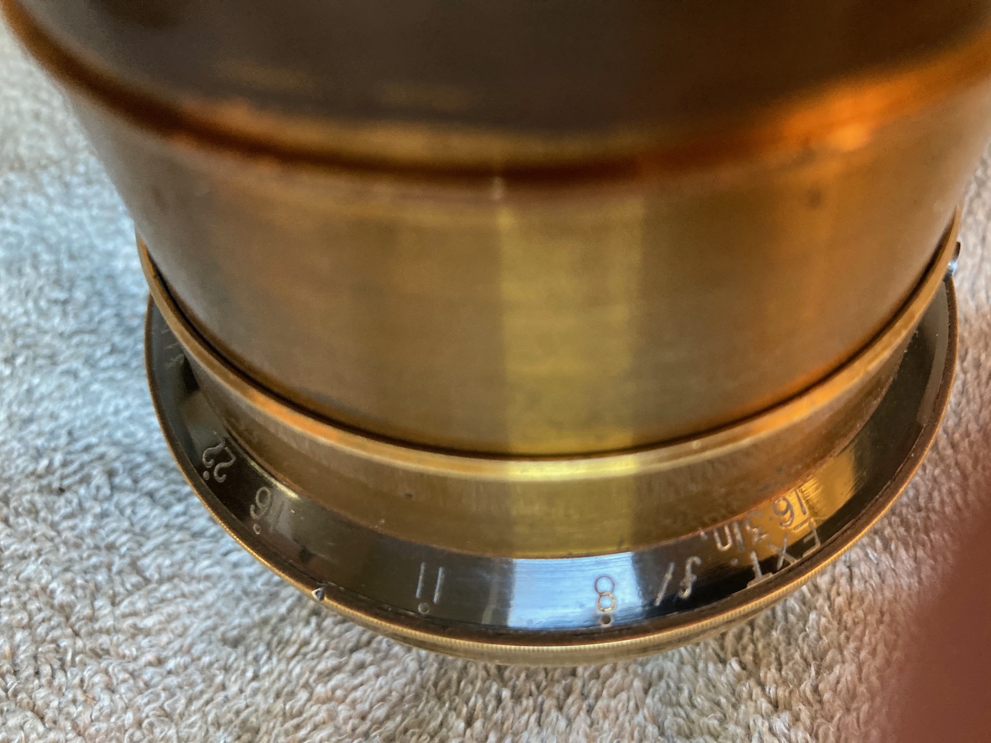

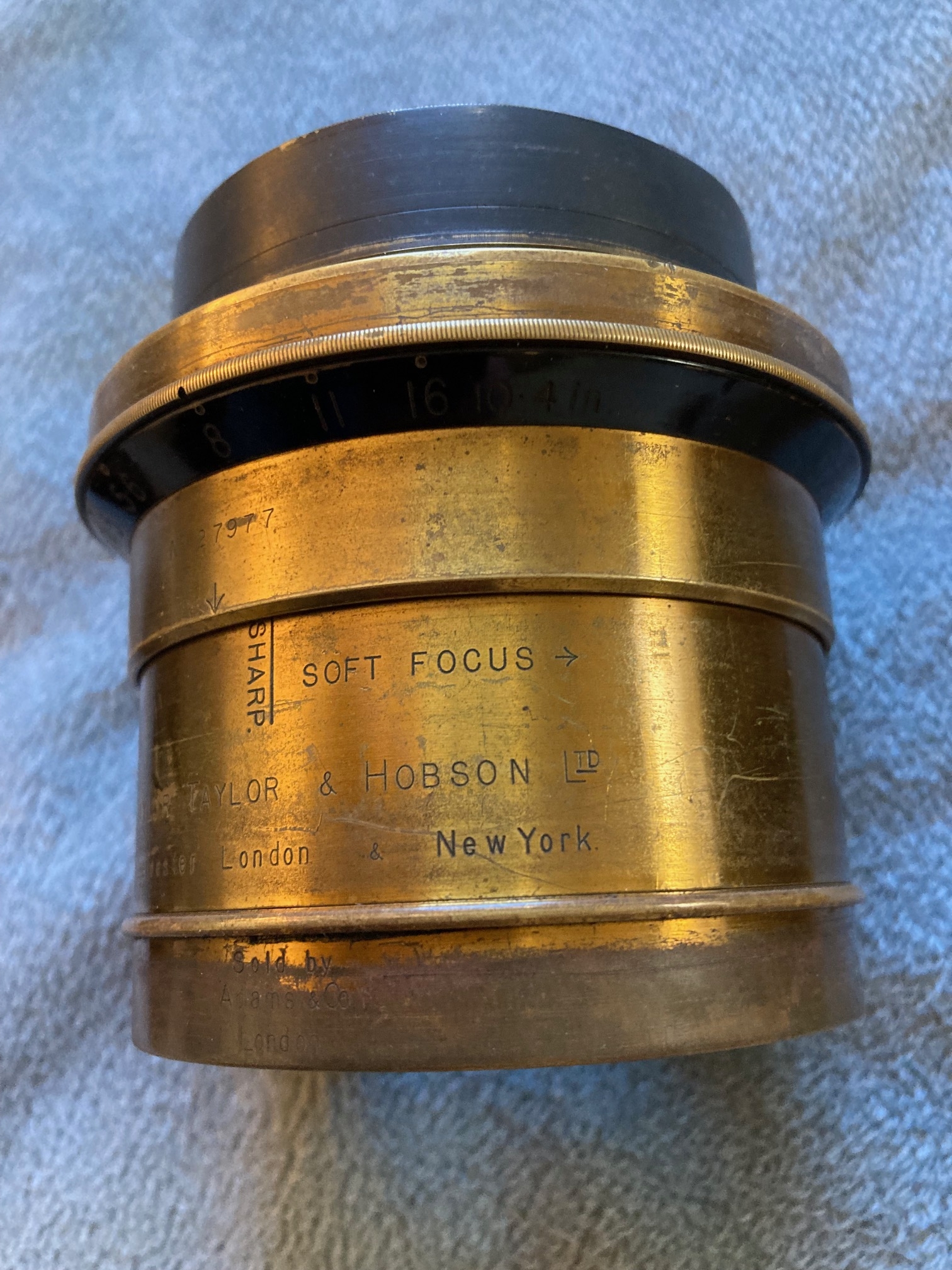

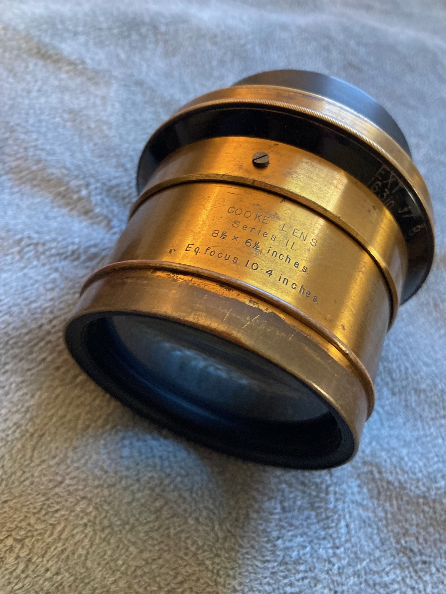

I was looking at my grandfather’s Taylor and Hobson soft focus lens and was wondering how the best way to use it was. I have tried the soft focus ring and it didn’t make too much of a difference. Does it need to be used wide open to get the best affect?
It is interesting that I have correspondence from my grandfather and the company he bought the lens from in 1929. Suprizingly they sent him the lens on spec and only pay if he keeps it.
I have some of his pictorial style prints that clearly show a soft focus.
Thanks for any information.

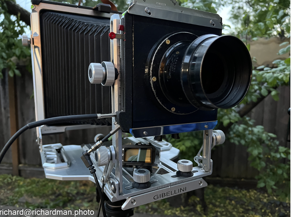

It's an excellent lens. I have a number of Cookes from the 1880s RVP, to the one you have there, and other ones. You can use it with a "lenscap shutter" for 1/2 seconds or longer, or a Packard shutter or a Sinar Copal shutter. The latter cost $ and could strain your camera's standard.
Here's a pic of my Gundlach front mounted to the Sinar Copal, the Cooke Series II is a bit bigger and heavier at about 3 lbs
My lens mounts to a Graphlex RB (ca 1913) that was my grandfathers. My father used it. I learned on it and it still works well. I just haven‘t gotten the control of the soft ability of the lens that I would like.
you will get more soft focus effect shot wide open, certainly above f8. I have the non soft-focus version of that lens - the Series II 10.5 inch f4.5. Looks like yours has markings to use it as a convertible (there's a marking on the aperture ring saying something about 16 inches and starting the aperture sequence at f8). IIRC, the effect of the "soft focus" dial on the barrel is somewhat subtle - it's not a Vitax or Verito where dialing the soft focus to 5 turns it into a defocused mush.
Yes, this lens is convertible . By removing the rear element it is a long telephoto lens that will barely focus on the Graflex RB bellows.
