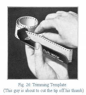

Years ago, I adjusted the caption on this image:
I don't known why he's bothering to trim that film, since it's not even in a cassette.
But I guess this illustration is where people get "Cut to the 23rd perforation." One perforation is obviously wasted by this guy.
When I bulk loaded film I used one of these without slicing my thumb.
You had a screwmount Leica?
There's no need to use a template to cut 3 inches of film. Just look at it and do it.
Also, you clearly ignored the trajectory of the blade and left your sense of humour on another thread.
No, it was the simplest and easiest to use in the 1970's and 80's. I got the humor and added that I moved my thumb and left the cut thumb for the 'u' in your humor.
