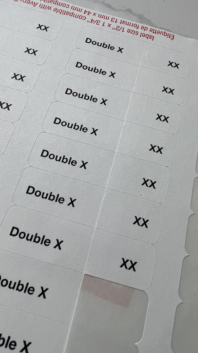

35mm Pan
To mark film type on cassette I'm using Avery labels #5267 printed in laser printer, ~⅔ of label goes to side of cassette and ⅓ on the top of the film container. One sheet has 80 labels. In the last few years Microsoft dropped from MS Word very neat labeling application that allowed printing even one single label on the sheet, but to print whole sheet is still easy and possible.

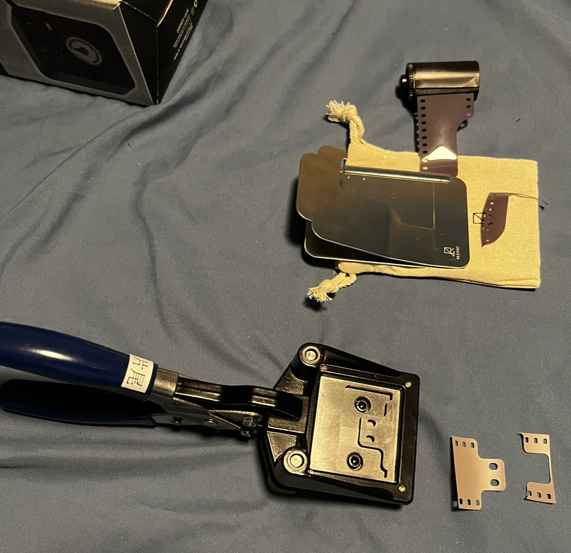

I am so happy with this tool. I probably don’t even need to put a tape anymore. I still do a little piece just in case
What trimmers are those and where did you find them?
I am using an ablon style template for my barnack and just cut the end off at about 45 degrees for everything else, but I still think it's cool that proper tools are out there.
Radost
Jan 21, 2021
1,629
USA from Ukraine
Razivot lead cutter is a replica of the Fuji giveaway made in 1984 Olympics for journalists.
Reflxlab end cutter/puncher
Both a little pricy but pleasure to have and a big time saver/
I just ordered one of the Rezivot trimmers from the Brooklyn outfit that is US seller. I don't need it but it's really cool. 😊
