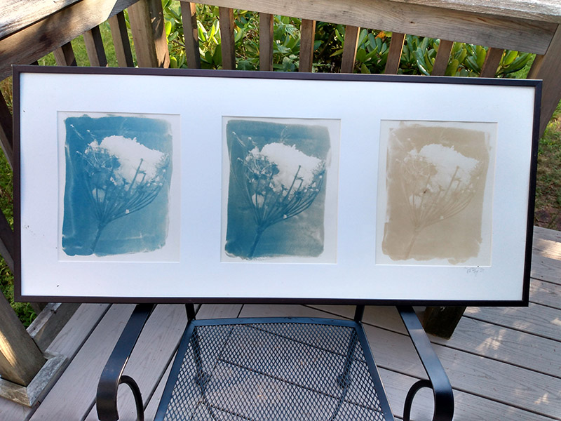

Here is a quick snap (from this afternoon) of a cyanotype triptych that has been hanging on my wall (out of direct sun) for roughly nine years. The prints were made and framed in 2006. They were displayed in a couple of exhibitions and then stored until I hug them in our house (as I said nine years ago).
The left print is an untoned cyanotype. The middle print was bleached with ammonia and toned with tannic acid. The right print was bleached with sodium carbonate and toned with tannic acid.
For comparison, here are scans (composited into a single file) of the exact same prints shortly after they were made:
I'll let you draw your own conclusions.
It is well known that cyanotypes under glass do fade with time (see Mike Ware's Cyanomicron book) and that they can be restored upon re-exposure to open air in the dark. I have not tried this with these prints, but know that the frame is off the wall, I may try this.
