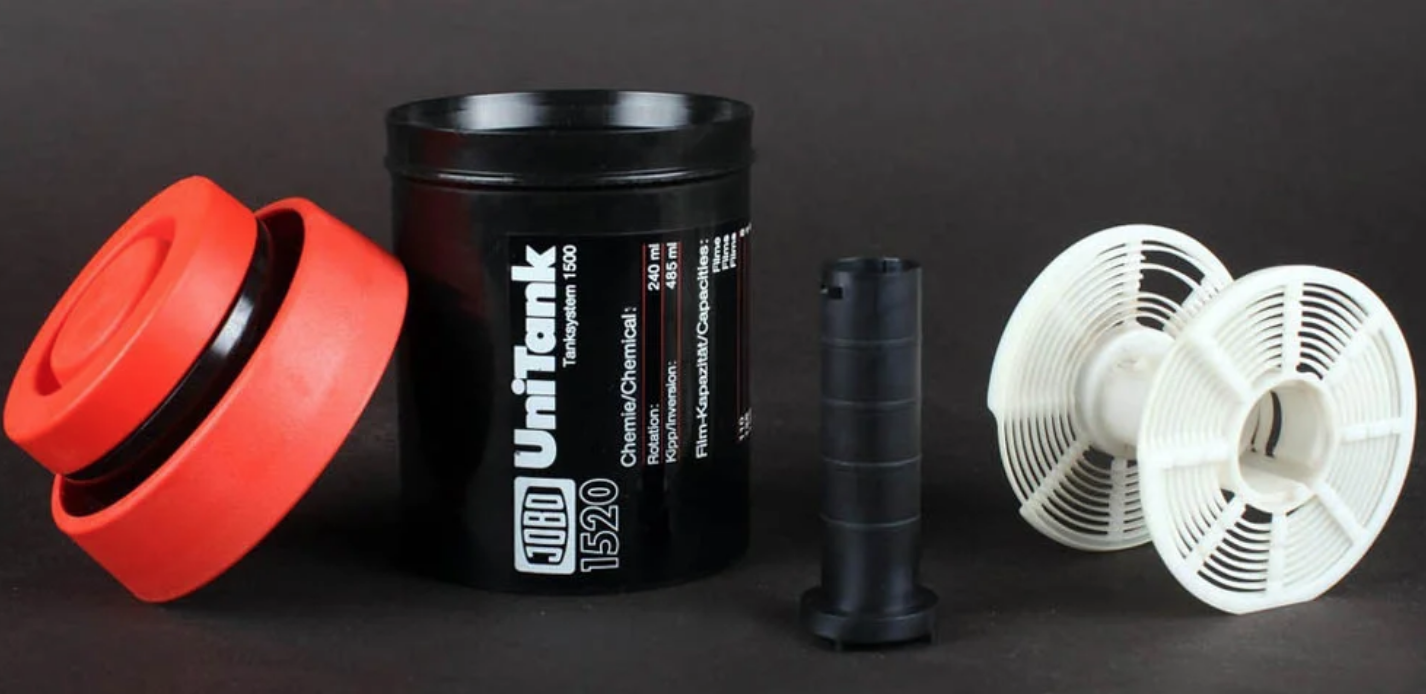

I'm a huge fan of Jobo 1520 tanks. 2 rolls of 35 or 1 roll of 120. B&H USA sells them or avail on Ebay.
If I understand correctly, any reels that are to used with Jobo tanks must be especially designed for Jobo, right? (I am pretty sure the Hewes reels I just bought are not the "Jobo" versions.)
What is it about the Jobo tanks that makes them worth the extra cost and effort to find compatible reels? Not trying to be argumentative; I am just trying to learn from more experienced users.

Compare to Paterson tanks, I find the Jobo tank lids are easier to remove and replace for filling and emptying, making changing solutions quicker. On the other hand the sealing ring that hold the lid in place can sometimes be tricky to close correctly after you've loaded the reel in the tank.
No, their reels are specific to their tanks. The lid system, as Pieter12 mentions above, is IMO,a better seal and offers a more positive
grip for inversion processing. I have used Paterson (not a fan of their tank and lid design), Hewes St. Steel tanks and reels etc, and I prefer the Jobo. Clean reels are the key to better loading I've found...fotoflo can leave a residue I think,
so I clean mine well after use.
Beware photoflo residue! I have had problems with developer foaming from the slightest amount left on the reel. I now wash the empty reel in the tank as I would for film after I'm done.
