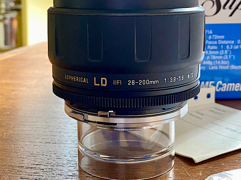

Last year I bought a Tamron 28-200 for Minolta MD, which the seller said had never been used and is in its original packaging with all the paperwork.
It later turned out that the zoom lens in the rear, second to last lens unit is cloudy. Cleaning is not possible because the unit cannot be opened.

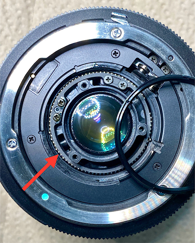

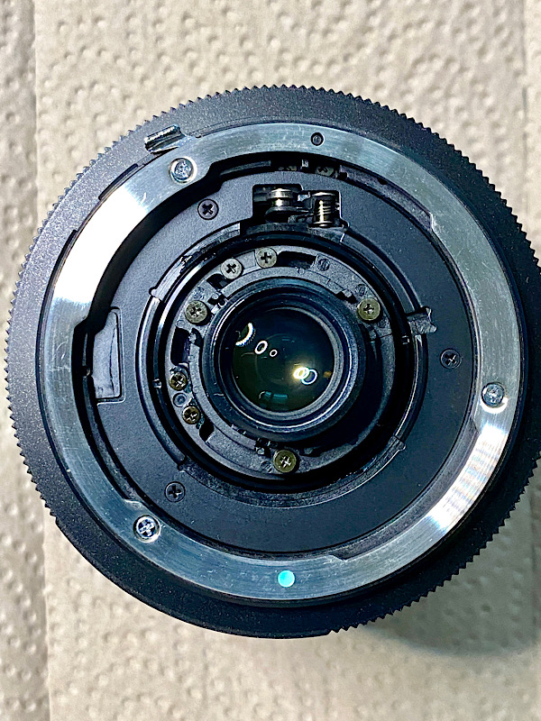

The rear lens unit can be removed after loosening three screws.

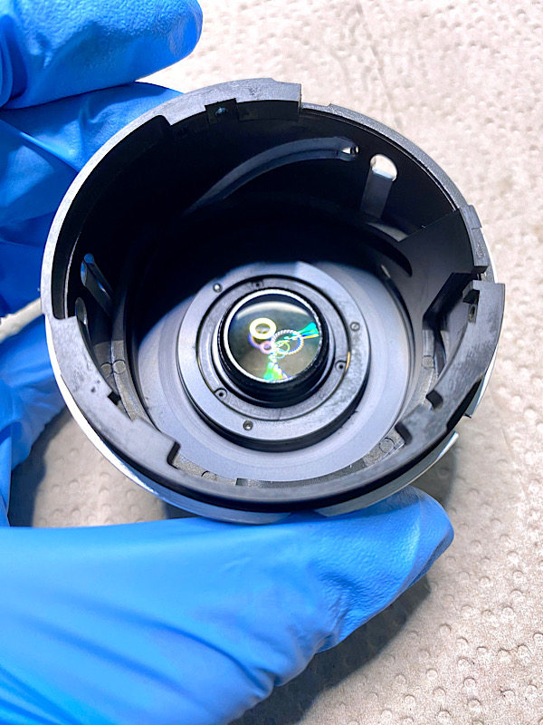

In order to get to the lens unit underneath, where I suspected the clouding, I unscrewed this retaining ring.

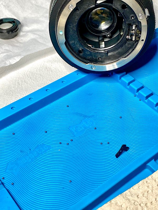

There are tiny balls here that act as bearings for the aperture. The balls are magnetic.
I reinstalled the retaining ring and attempted to continue the disassembly by removing this cover ring.
Then I loosened the retaining ring again to remove the balls, in the hope of getting closer to the lens unit. The balls rolled into the tube and most of them stayed there, held in place by magnetism and grease.
This meant that the repair attempt became a dissection. I wanted to at least find out whether the opacities could be removed and where they were located.

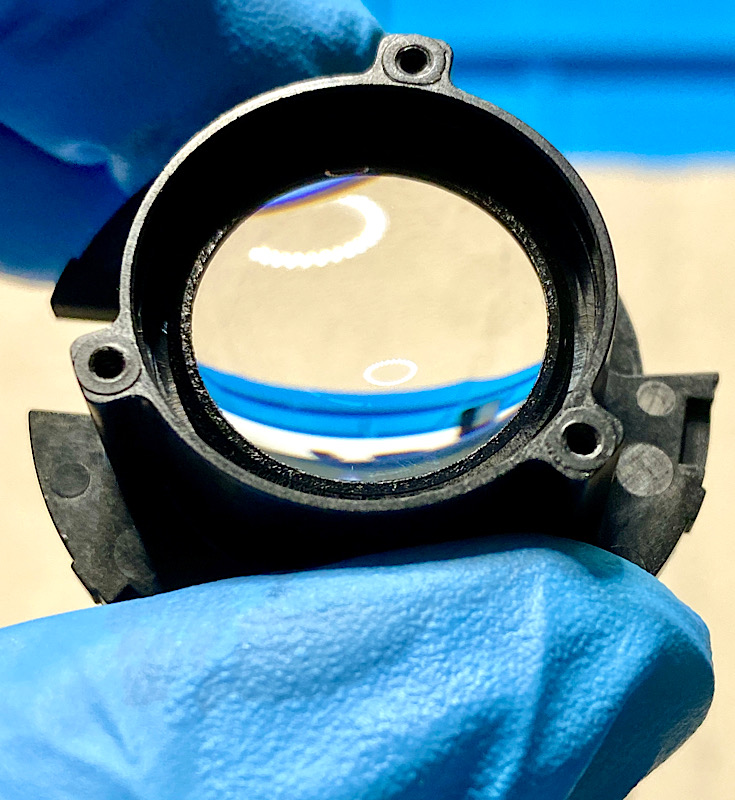

The opacities were on two lenses. One of them was above the aperture (left unit containing the lens) ...
… and the other on the inside of a lens in the middle of the tube.
Both lenses could be cleaned with isopropyl alcohol.

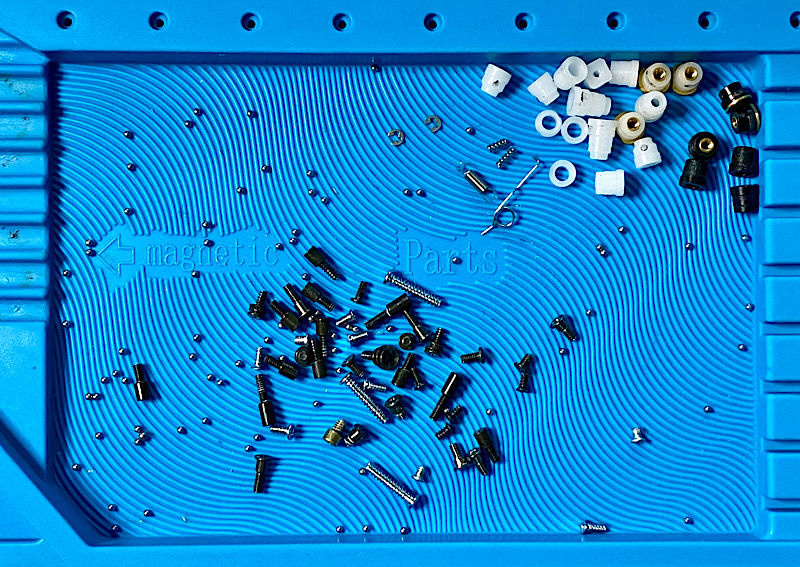

Replenishment for my spare parts warehouse. Plain bearings, balls, screws, springs and two tiny circlips.

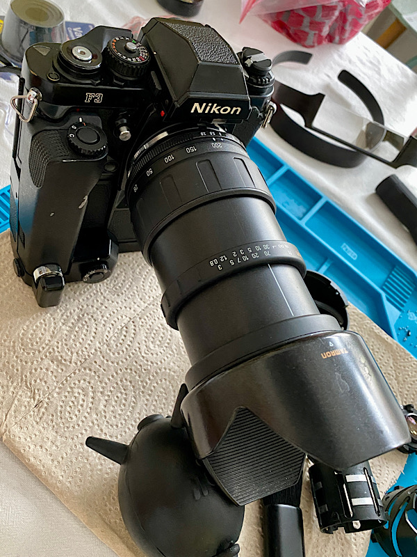

I have now cleaned the Tamron 28-200, which was actually intended as a spare part donor, and tested it on the F3 with the corresponding Adaptall-2 adapter.
I cannot see any faults and am wondering why the seller sold it as defective and therefore cheaply.

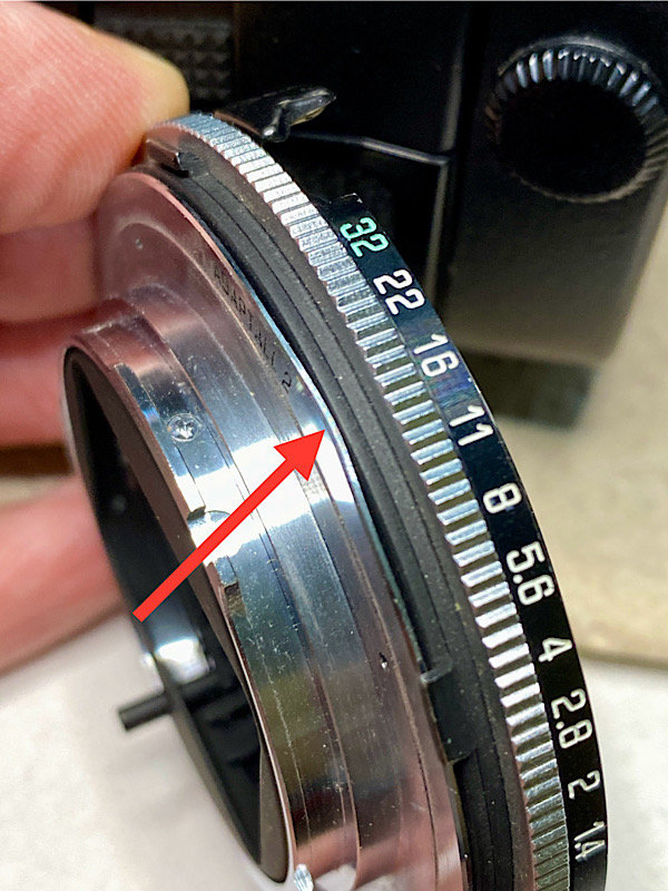

On this occasion I discovered that this Adaptall-2 adapter for Minolta MD is defective, the bayonet is bent.
It is not worth attempting to repair it, the bayonet is no longer dimensionally accurate and will never be.

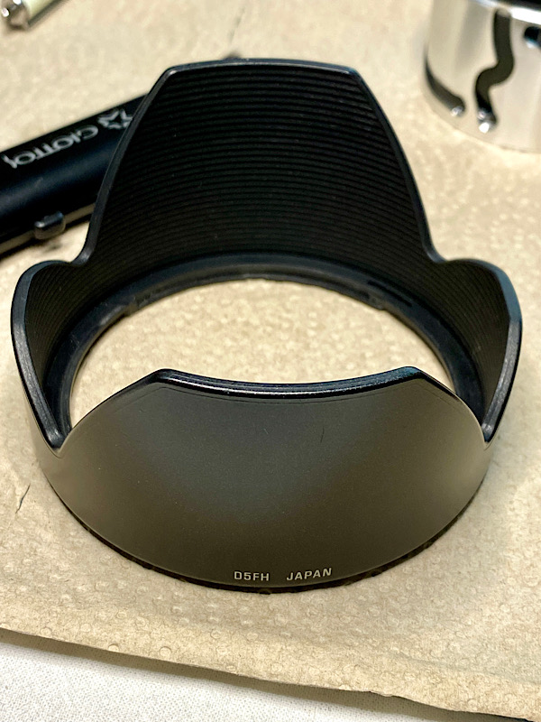

And finally, I take a like-new lens hood from the dissected lens …
… and have another magnifying glass for my repair work.
No, the bayonet itself isn't bent - only the thin outer rim beneath the aperture ring where because of the recess in the fixed tube.
I count all of this as part of the bayonet.
But if something is warped in this area, I won't try to repair it. The specification is no longer correct.
As far as I can see the zoom you have shown first has a TAMRON AdaptAll adapter for Minolta MD.
Why not use its Mount for that item which was actually intended as a spare part donor and is now working perfectly?
