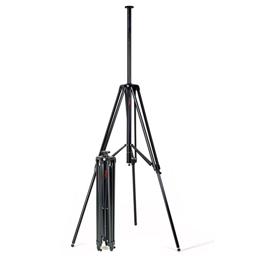

Kudos to Linhof for replying after I sent them further info from the above eBay listing. They say the following is the successor to the Rekord Profil above:

EDIT: to add another question--I've never owned tripods where the legs have braces to the center like the Linhof you linked to. I've worried that they might not work as well on uneven ground where many of my shots are made. As an example I once too a shot of a small waterfall standing on a small boulder that was too small for me and all three legs of the tripod. I was able to extend the legs and change their angle so I could get it mostly level. I don't think I could do that on the linhof, but I don't know since I don't have one to try out. Do other like having those braces?
My old Gitzo does have the braces for each leg. They are totally independently adjustable, so not difficult at all for uneven terrain.
On the other hand, I saw some heavy duty video tripods that have the braces linked at the center. This is probably for faster setup. Besides, you can still adjust length of each legs with one of the sections.
The braces on the Linhof are detachable from the center column (you just spread them laterally a small amount ) which allows the leg angles to be adjusted individually as needed. Clever. One of my favorite features of that particular tripod.
