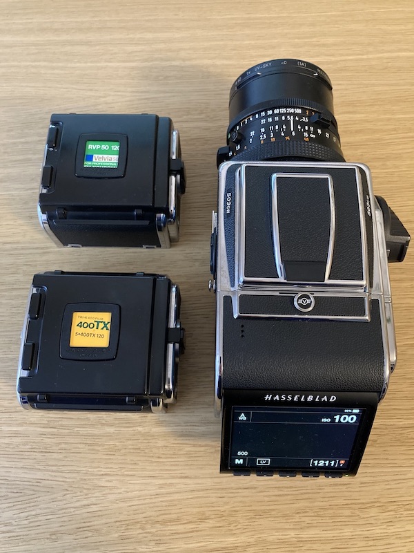

Another thing that I would do is to offer a hybrid digital/film system comprised of changeable backs, one housing the digital module, and the other securely holding a roll of film (light tight) for instant swapability (if possible).
But the light tight part would be quite an engineering feat!
Already exists:
Granted, the V-series Hasselblad is not available new. It would be great if Hasselblad would restart production of those (I doubt it will ever happen, though.)
As a side note, that CFV 50c ii back is truly fantastic and shines with the Hasselblad. Old glass (here a 60 CF) works very well.
Sure, we could argue that the sensor is small for medium format ("only" 33x44 mm), but anything larger (e.g. Sony's larger 44x56mm sensor) would be too expensive for us mere mortals, even €6k which this one costs is a stretch for many (myself included.)
I find this is the "ultimate" film/digital combo: take pictures on film and use the digital back to scan them.
