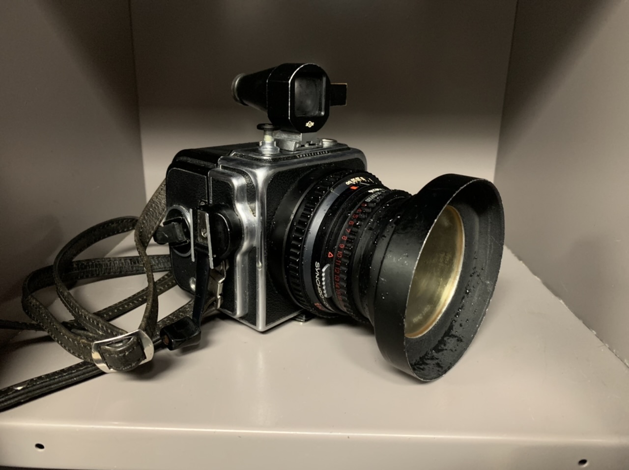

Alright, I decided to roll the dice on it and get the black SWC/M at KEH that was in "ugly" condition for $1250 and comes with a finder. I've been eyeing it for at least ten days. As documented in other threads, I don't trust KEH ugly condition, but I have also been lucky with it about half the time. Fingers crossed that just the finder or the body is ugly and not the lens, but we shall see. That's where the dice roll comes in: if it's in good shape I get an SWC. If it needs to be returned, then maybe the groundhog sees his shadow and it's six more years of no SWC. Fingers crossed.
The arguments against were good, by the way. Wide angle may not be my FoV. I will consider this a fun challenge to see what I can do with it. I'll give it at least ten rolls and then reconsider - maybe I haven't given myself enough of a chance to fall in love with wide? If the lens is in good shape I am sure I could make money on the resale if I had to re-sell it. To everyone who said I was just bored, you are totally correct. Hopefully this will be the fun kick I need to go out and take more pictures after a year of working from home and letting each day blend into the next. Plus, my birthday is coming up :smile:

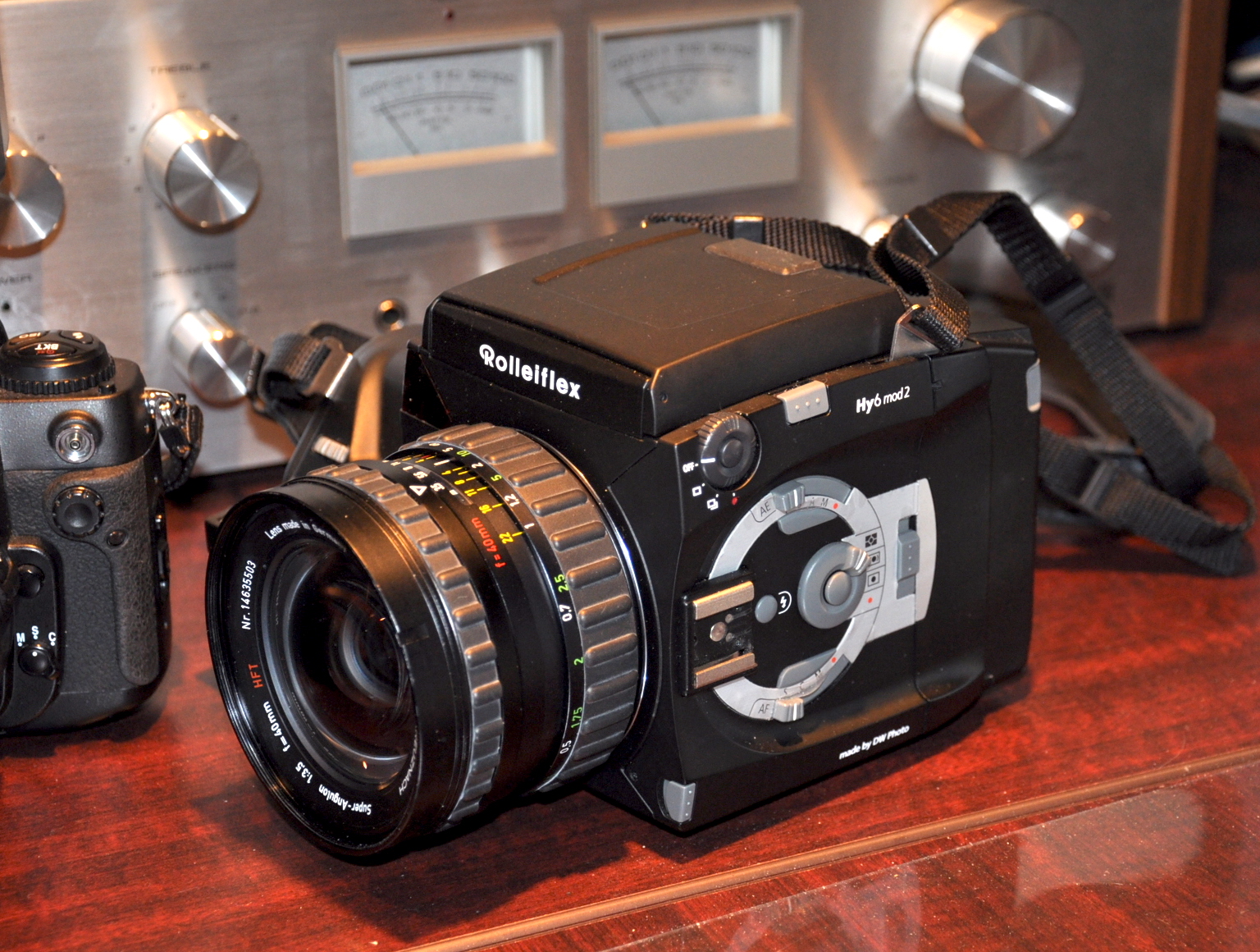

Do they offer the little Super Angulon 40mm for the Hasselblad? On the Rollei Hy6 the 40mm f3.5 is fast, light and compact even with motor drive, auto exposure, matrix metering, focus assist, TTL flash, etc.
