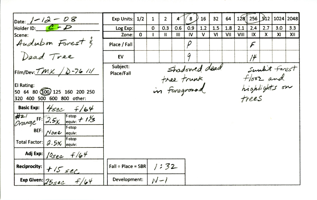

This is what I do, not really uncommon from what anyone else might do who is into the zone system way of doing things......I used to take notes in the field, but came to not wanting to fuss with writing while in the field. I find it far easier now to just use a digital voice recorder to document the notes, then, usually in the truck before leaving, I'll quickly put them on a card like this. It takes practically no time to do........I find that notes not only help diagnose problems but they also reinforce what went right on those occasions too.

I have little pre-printed sheets that go in the ziplocks with each 4x5 filmholder that are similar to CPorters above.
I'll note the aperture, shutter and dynamic range of the scene. Then I'll note what development will be appropriate.
Then I'll note the lens used, and filters of course.
Date, location etc….

At one point in time, I was jotting down zone values and development adjustments for each roll of B&W in a little notebook I keep in my camera bag... I used to make my own little zone diagram like CPorter's example provided. I haven't really done that lately, since I generally don't take that camera bag (along with the little notebook) out with me. I keep trying to get back in the habit, but it's been to easy to be lazy. I just hate it when I get a nice exposure and I can't remember how I captured it...
I think everyone's contributions above just might help me get back into the habit of recording information again! Hopefully!

I do 99% sheet film. I have color coded, paper gaffer's tape for emulsions which I affix to both sides of a holder. I record the subject, date, filtration, lens, rated film speed, aperture, shutter speed and zones. If I have a notion about development, I record that. Once I develop the film, I add that little bit of info to the tape, peel it from the holder and stick it on the negative envelope. Never have to transpose, correlate, copy or maintain a log or spreadsheet of the information..it's automatic..

Where did you get these sheets? That's quite clever! I'm finding that while in the field, I'm attempting to write down details about each shot, but this takes time and it is annoying when it's 15 degrees (which it is here is PA today!).
That said, I find it to be vital to learning precisely what happens with what exposure settings. Any other advice would be welcome.
Thanks!
