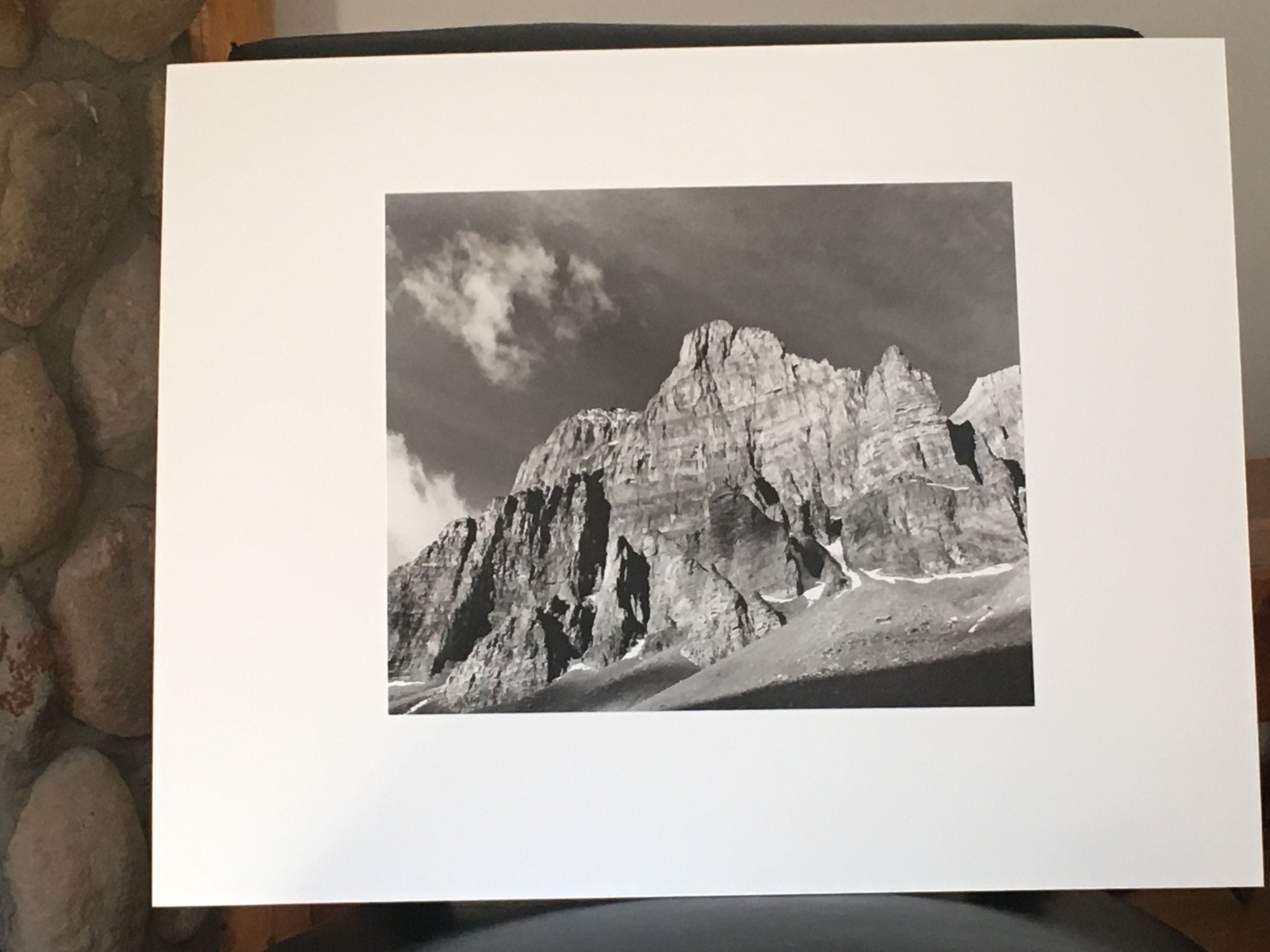

Gosh, miha. You've still got some EMaks? I have about 60 sheets of Gr 2 glossy 20X24, and got worried if it was still good, so printed some 6X9 Tmax shots on it last week (nominal 16X20 size plus a nice-sized test strip off the edge), with wonderful results. 130 glycin developer. I sure miss those classic graded papers. EMaks has a subtlety to the tonality one just doesn't get with VC papers, plus a wonderful understated subtle warm glow, although one has to be careful toning it, because it tones so fast.
But Craig .... My gosh, being able to bag tonality all the way from deep shadows to gleaming highlights, even in glacial ice, is exactly why I shoot TMax100 (mostly smaller formats, but potentially all sizes), or TMax400 (more in 8X10, but sometimes clear down to 35mm). There is simply something wrong with either your exposure technique or developer choice, or both, if you're not finding that out for yourself. Don't blame the film! The characteristic curve profiles of both TMX and TMY are very similar, and only the speed is different in that respect. So the logic of your complaint doesn't work either.
