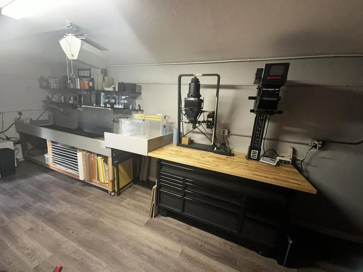

Looks like butcher block to me, unless that is a veneer.
