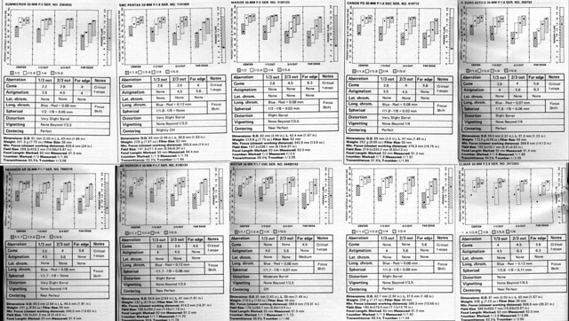

I don't mean "mechanical measurements". I've seen magazine tests where, besides the actual measured APERTURE (actual measured f/stop in physical terms), they also compute the actual T-stop you get when the lens is wide open.
See:
Normal 50s 1977 by Jussi, en Flickr
