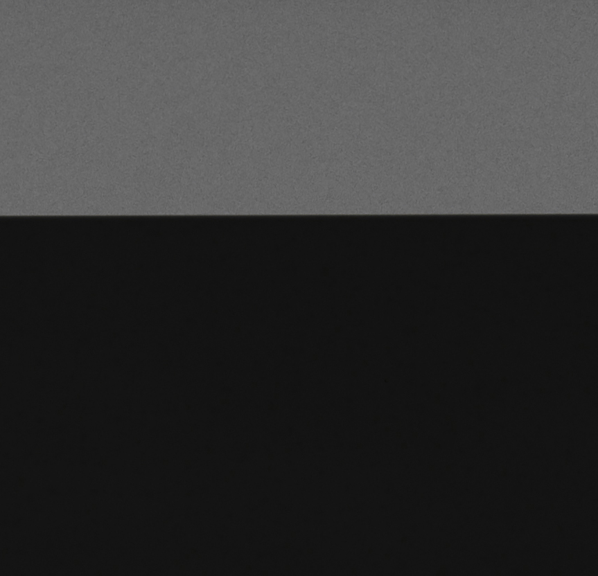

This must be it. It could be mistaken for grain, but it is not, because it also shows on an entirely unexposed and undeveloped film that has been through a sequence of "alkaline solution-wash-acidic fixer". It is also not a typical reticulation, as it is much finer. Since it shows on a 120 film that is sealed from air for the most of its useful life, it should not be caused by a noxious vapor. The real problem is that its appearance is variable. If you can get your hands on a 400 ASA film which is past expiration date and do not expose and develop it, just cycle through solutions as above, you should see it in its most basic form.
Here is an example 100% crop of a file manipulated in the way I described. The dark portion is a patch of sky in one of the frames, the upper brighter portion is a blank piece of the roll. The grain/frosting pattern is subtle, but quite clear.

So an update on this situation:
I have now shot a roll from the batch 157 box, processed in Pyrocat-HD, and the bad news is the problem is still there. It definitely seems less severe than the other one however, but is still enough to be bothersome.
I guess all that's left is to try and seek some kind of compensation from Kodak and avoid this film (at least for the time being). It's annoying though, as I like the results from TMY-2 otherwise. Oh well, I guess I'll have to switch to Delta 400 and live with its larger grain and higher contrast.
