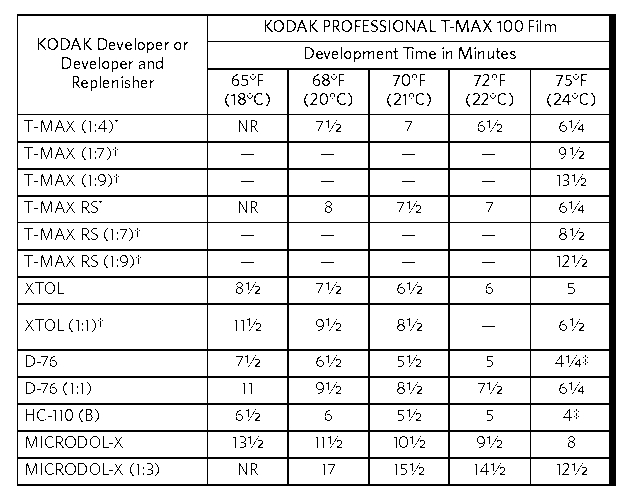

EI = exposure index, the practical term for film speed. It means that is how you set your meter. '21' is the temperature, in C.
Since ID-11 is Ilford's version of D76 and is functionally identical,
here is Kodak's chart for TMY. Assume agitation for 5 seconds every 30 seconds.
Good Luck.

The 100 is the old A.S.A number and the 21 is the old D.I.N number, long superceded by I.S.O. which incorporates both speed rating numbers hence 100/21.
The processing time is for 20C (68F).

EI is the exposure index, not the ISO rating. So if you see an EI of 200 for a 100 ISO speed film, you can safely assume that the processing time given is for a 1 stop push process. TMax films' documentation is a little different in this regard. The normal time given by Kodak is for an EI of 100 or 200. They claim that a sufficiently good negative for many applications can be had with normal processing and one stop under exposure. I've tried it and they're right. Shadows suffer some, but all in all you get a decent negative that you can work with.
And yes, ID-11 is functionally equivalent to D-76, so do use the Kodak recommended times and procedures. I used to use ID-11 when it was less expensive than D-76. Now the pricing is the other way around for me, so I use D-76. Can't tell the difference between the two.

Well I'm still scratching my head a little here and now after spending a bit of time with my head in the books it looks a possibility that the film could be under-developed, I'm going on the weak looking negatives and fairly faint edge numbers. How I read it was following the Kodak chart at 1+1 and 20' the time would be 9.5 mins. Any thoughts?

If the temp was correct, and the exposure was OK, you should be close.
Contact print them and see how they look.
The eye is a poor judge.
