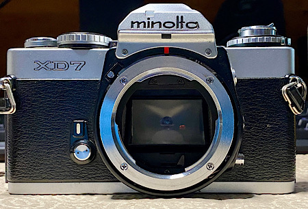

If the mirror on an SLR stays up or the camera is not receiving any power at all, troubleshooting often begins more or less immediately.
A few thoughts about what the cause of the error might be, plus experience and intuition, a look at the web, a quick consultation of the available technical documentation and the diagnosis is made.
Risky dismantling, no direct success control possible
As is the case with photographic equipment, it is often necessary to dismantle it more or less deeply to get to the suspected location of the problem.
No viewfinder displays light up, the camera shows no signs of life. How can troubleshooting be carried out effectively?
This is always risky, as damage may occur or reassembly may no longer be possible.
Once you have arrived and repaired the suspected error, you often cannot check whether the repair was successful; this is only possible after (partial) assembly.
If you were right, the device will work again.
If not, hours of work may have been unsuccessful.
Is systematic troubleshooting therefore better?
Would it improve the chances if you systematically diagnose the error and invest more time in this?

Cameras, especially 35mm SLRs, are built from modular subassemblies. The standard method of repair is to separate the major subassemblies (chassis, mirror box, shutter, etc.) and evaluate them individually. It's much easier to identify malfunctioning mechanisms once they have been isolated from the rest of the system.
I know "you have to take out the mirror box" sounds like a big job, but it's really standard practice. That's just how you do it.
But even though I know that, I still haven't located the error?
I then have to decide in which part I am looking for the error and need an idea how to proceed.
In the case of electronic cameras, and in particular, Minolta electronic cameras, I might want to gauge how much current the camera is drawing. Even brand-new LR44-type camera batteries can be depleted very quickly if current draw is excessive.
How do you determine this?
Cheapest and easiest way is to measure battery voltage before installing them into the camera, and again afterwards. If they are considerably weaker just after being installed for just a matter of minutes or even seconds, your camera is drawing excessive current.
It should also work with a resistance measurement from the positive battery contact to ground. The battery's nominal voltage divided by the resistance gives the current that flows (assuming fresh batteries, internal resistance ignored). If you know the capacity of the battery, you can calculate its lifespan when the camera is idle.
