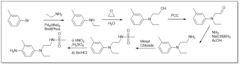

Edit: I missed out a step where you brominate the alcohol and use ammonia before you stick on that sulfone like group.
There doesn't appear to be any total synthesis of this in any literature, found a couple of 2 or 3 step routes that used starting materials you'll never find. The near impossibility to find CD3 in the UK and Europe paired with a bit of boredom had me wonder if synthesis is feasible. I got out a pad of paper and this is what I came up with, CD4 is almost doable but the lithium aluminium hydride, can't imagine that being easy to obtain, there's other ways to do this step but not many ways that will prevent over reaction without finding some difficult to obtain chemicals. This was my best attempt at devising a synthetic route with home synthesis in mind, there are nicer ways to do this but the issue is getting the chemicals, which would be even harder than finding CD3 itself.
So I suppose this is for fun/education only and makes it clear just how this isn't something you're going to do at home, this wouldn't be particularly safe without a fume cupboard, step 4 with mesyl chloride is where things fall apart, it's pretty nasty and I don't think you'd have much chance buying it. May have missed some workup details and haven't covered any purification steps, but I think it would be redundant to bother with it at this point. And like I said it was just for a bit of fun.

I see numerous pitfalls (and some errors) with your proposed synthesis.
The methyl bromoacetate in the first box is commercially available (and cheap), as are all the intermediates of its synthesis as shown, so there would be little point in carrying out that synthesis other than as a technical exercise, or if you wanted to produce kilos of the stuff. Your proposed bromination at the end would also possibly produce a mixture of compounds (i.e. over-brominated products), which would then need to be separated (probably by distillation).
Your first two steps in the second box would also very likely fail, for a couple of reasons. Firstly, alkylation of primary amines with alkyl halides is almost impossible to control, as the product you form (a secondary amine) is more reactive (nucleophilic) than the starting material, so you get mixtures with over-alkylation products (i.e. the tertiary amine or even the quaternary ammonium salt). Secondly, anilines are poor nucleophiles, so the reaction would probably require generous heating to proceed, which would only exacerbate the previous problem. A much better choice would be to use reductive amination with the corresponding aldehydes (rather than bromides) for both of these steps. The (missing) proposed amination of your bromide with ammonia two steps after that would have a similar problem; you could however do it from the bromide with a Gabriel synthesis (i.e. with succinimide/base, then hydrolyse the product with hydrazine).
The Friedel-Crafts methylation you then propose is also a terminal problem for the synthesis, in that you would not get that regioisomeric product. The nitrogen in anilines is electron donating into the ring, and would therefore direct the methylation ortho and/or para, not meta as you have drawn it. The nitration as you have drawn it is fine, but again you would probably get mixtures of regioisomers (i.e. not just the 4-nitro, but the 2- and possibly even the 6-nitro compounds too).
Also I agree that this synthesis is definitely not something you could safely attempt at home. LiAlH4 in particular is very dangerous to use without the proper precautions and experience, and tin reagents are also very toxic (you could easily do that reduction with iron & acetic acid instead).

I was a bit tired when i put this together, yea that +M nitrogen would direct to the 2 or 6 position, but it doesn't matter no one is going to synthesise it, when I first scribbled things down I did make that part first, you'd probably face there issue there of though of having to isolate the right isomer. But this just all points to the fact account for the worst case as far as getting reagents, and assuming things worked its not really practical. I agree it would be a messy synthesis.
You can indeed use aniline as a nucleophile, its done in the synthesis of fentanyl although it is a slow reaction, then they follow up with an acid chloride for the final step, I'm guessing they just rely on kinetic control once the secondary amine is made.
I didn't reckon it would be the best means but there's a that limitation of getting decent materials, something being commercially available and cheap doesn't forgo the need to synthesise something, members of the public can't just buy things like this. If we were going to just go by readily available materials you could probably make this molecule in 3 steps. I just chose bromide as they are easily made from materials almost anyone can buy but the need of reducing agents and of course mesyl chloride, make this all a big no.
And yea over reaction for the step I missed out.

True, it's still nasty. Another option would be to use monoethyl oxalylchloride, then reduce the product down with LiAlH4 (but this would be problematic on scale). There are also approaches to make it using palladium catalysed cross-couplings.
It goes without saying that any serious wet chemistry should never be performed without PPE and a fume hood.

Just for the sake of completeness for myself, obviously completely impossible without a sigma aldrich account and a proper fume cupboard. I was a bit drunk actually when I came up with the attempted home brew version hence all the silly mistakes.
