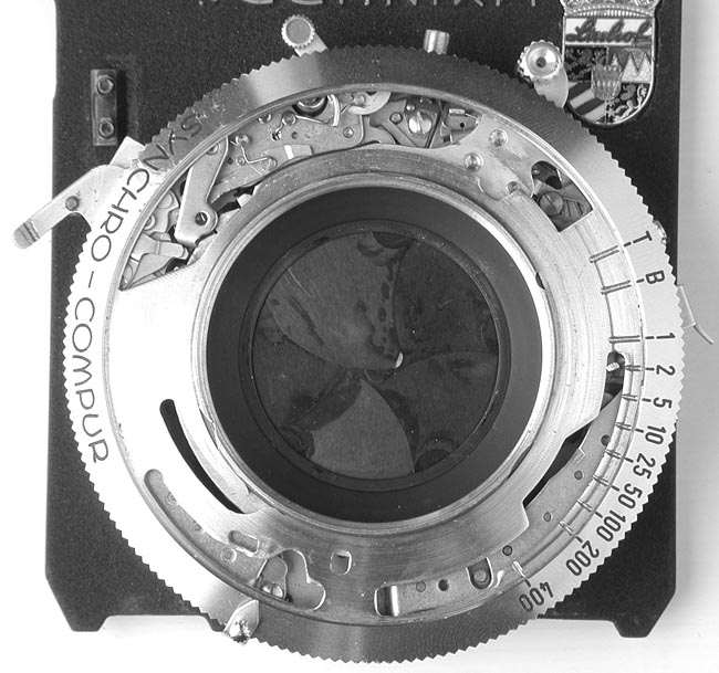

Take a look at the attachment and tell me what's wrong with this picture.
I've worked on Synchro-Compur and similar shutters before, but this one's of more recent vintage. It was about a stop slow on all speeds, so I flushed it out with naphtha, and now it's running much better, but the B & T settings aren't working. I've obviously got a pin that's not engaged or maybe a spring that's come loose, but I can't figure out where it is.
Any suggestions?

Okay, looking into this further, I realize that B&T are controlled by the two latches, one hinged right next to the "S" with a hole at the other end and the one just about 3 minutes clockwise from it, hinged closer to the lens opening. Immediately clockwise from the hinge for the first lever near the "S" there is a pin with a spring resting against it, and I think this spring needs to attach to something at its end, but I'm not sure what. Any ideas?

FWIW I had the same problem with the same shutter and I ended up contributing it to wear after messing around with it for a long time. I have fixed many a complicated mechanical thing in my life but I was stumped by the shutter. I just could not get it to work appropriately. It might be worth it to send it somewhere (like Grimes or Flutot's) or just write it off and get a replacement if those settings are important to you. This may not be a lot of help, but it may save you the aggravation that I experienced.
Good luck David.
Patrick

Thanks, the diagrams are particularly helpful. There's one spring I'm not sure about, and this is a hint.
The shutter is otherwise working nicely, though, and it's not a lens that I usually use for long exposures. It's the 105/2.8 Xenotar that's mainly for handheld shots with my 6x9 Technika.
