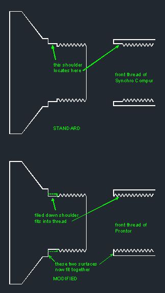

In doing so, I wondered about the thread size and tried the Super Angulon cells which fitted!... Except that the overall length from front to back was about 2.5mm too long.
Eventually I realised that the front is threaded all the way up to the edge on the Prontor, whereas on the Synchro Compur, the thread starts a few mm into the barrel with a slightly wider opening at the edge. There is a corrosponding shoulder on the back of the front cell which fits into this. However, on the Prontor, the shoulder prevents the cell from screwing in all the way so despite the shutter data showing an overall thickness of 16mm for both shutters, they might not always be compatible.
After a bit of thought, I decided to file down this shoulder (please don't judge me - the lens isn't in pristine condition so I'm not destroying anything valuable). I bartially screewed the cell back into the old shutter to serve two purposes. To protect the end of the lens from swarf and to provide a channel just the right widthto work as a guide for a thin file.
The result is that the front cell now fits fully into the front of the shutter and I am 99% that the spacing is now correct.

This is what I did: 65mmsa.jpg
Ideally, I should have done what you have modified the shutter rather than the lens but I don't think my lathe would hold the shutter accurately enough. It was easier to file away the shoulder. I think with the two surfaces perpendicular to each other being in contact, the spacing has to be correct.
