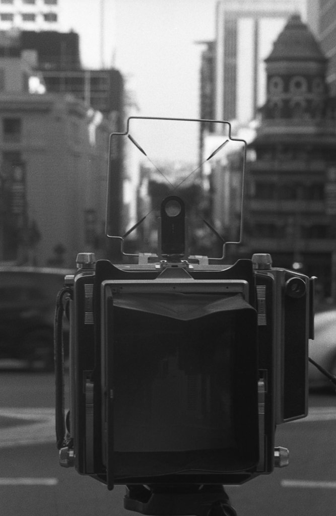

I took him out on a excursion to the city on Friday.
