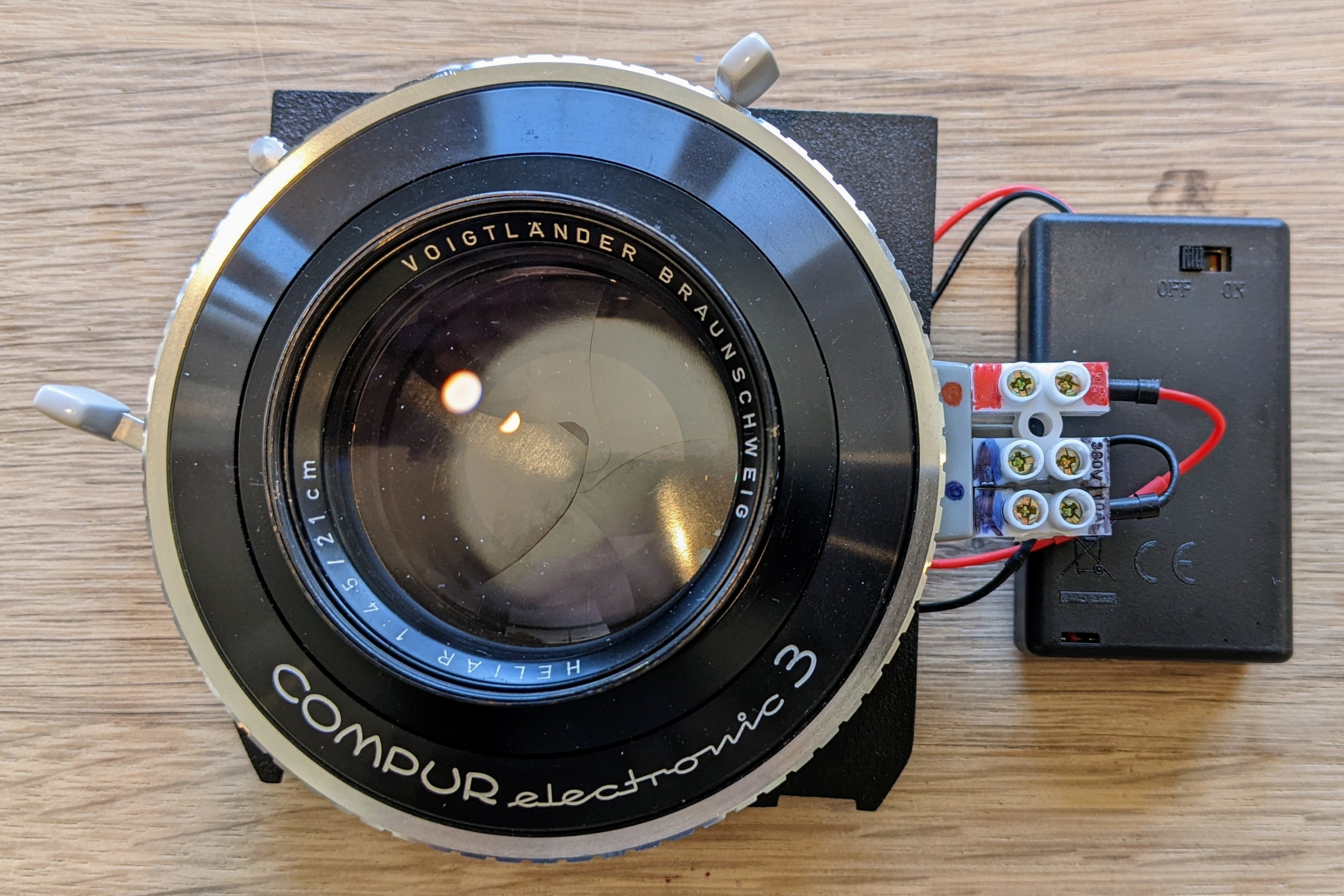

I recently got a beautiful Heliar 21cm f/4.5 in Compur Electronic 3 shutter, albeit without any battery holder. Thanks to Philippe-Georges, I now have a working solution just like his. The lens is from 1970/1971, so the shutter must have been of similar vintage. And it seems to work very well.
