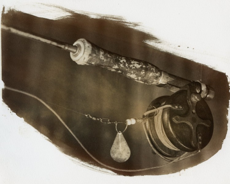

Thanks very much for the tips and suggestions, this is very helpful. I was taking a picture of an old fly rod, reel and a lure (non fly lure), wanted it suspended and old cord dangling and because fly rods have such a short but I couldn't keep the support string out of focus. Ill post up a pick later to show what I mean.
Its a 8x10 shot using my stupidly big Orbit camera and a long 15" tele lens, and it was windy and I had to do a 14 minute exposure and I mucked up a couple of shots cause the camera moved a bit and I was under pressure to get my wifes good table (back) cloth back in the cupboard before she got home......etc.
Anyway enough of excuses, I got one half decent negative I will do in Vandyke brown and I am now wiser for next time. I have a lot of old and new fishing equipment that may work as a picture.
awty
awty
Jul 24, 2016
3,643
Australia
I used a bit of poetic license with my brush stokes to hide most of the string, but you can see it on the butt.
This was a test print in Vandyke Brown, bit messy. Usually takes a few goes to get it close to right.
