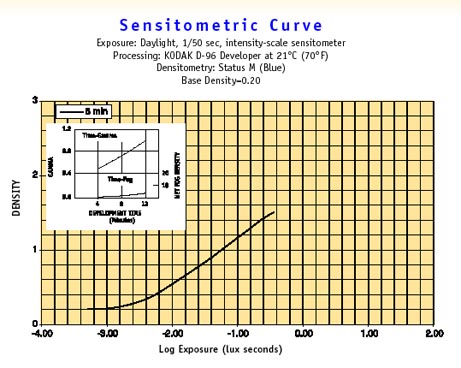

Cool. How does the curve resemble Kodak's ?
It seems E12 is one of those developers that reinforces
the film's signature: TMY becomes bolder, APX 100 dazzling.
Really interesting.
don

I think I took it farther out than they do except in the normal (7.5 min) where I ran out of film at the end of the roll. That one does, actually, look pretty similar, terminating, as theirs does, at about d 1.5. The 6 and 10 minute curves, where I trudged on up to zone 11, there is considerably more shouldering. Leads me to suspect that another interesting application might be white subjects on white. Have to do my old egg with axis light trick with it. Hmmmm.
One thing that their curve and mine conspicuously share is that nice graceful toe. I love shadow values; I'm gonna love this.
Larry
OOPS I should have mentioned, this is about kodak's curves.

....this is about kodak's curves.
In my world, Ilford MG prints normally up to D 1.50 ~ D 1.8, so it's good to know what happens beyond conventional curves.
