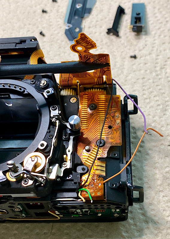

Minolta 9000
This electromechanical work of art is difficult to disassemble. It's unbelievable how many components were used and with what density.

Cameras from the 1980s and 1990s e.g. the Canon EOS 1N, Nikon F3, FE2, FM and many others ... they may look "simple" to repair, but underneath is a revelation that has struck fear into the most ardent DIYer. I surmise that DIY repair is a firm 'maybe' if one knows what the problem is and where, he has the temperament of a jeweller and the precision of a surgeon together with the refined skills of electronic and mechanical assembly. Without these assets, I wouldn't go near them, and even if I did have time and skill, there is much more involved to simply repairing — calibration, being one thing.

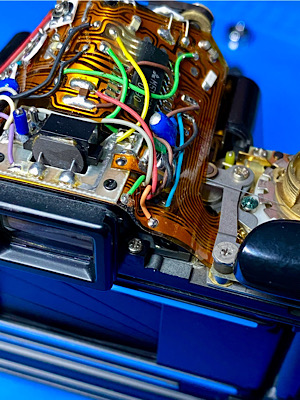

Four years ago during a routine electronic and mechanical clean-up, I witnessed the inside story of my 1994-vintage EOS 1N. Any notion that it was a simple few circuit boards here and there was immediately dispelled — a very, very tightly packed and complex assortment of circuits and miniscule spaces, very few actual wires, and where they did exist, extremely small. Much of the logic and circuitry of this camera has ancestry to Canons T-series cameras, particularly the T90. Elsewhere in the camera, what was trail-blazing new technology in the dawning years of the 1990s served as a testing and proving ground for the digital beasts of burden was see today. How things have changed!
