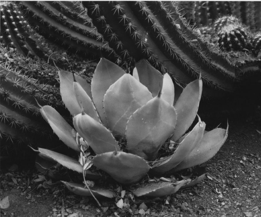

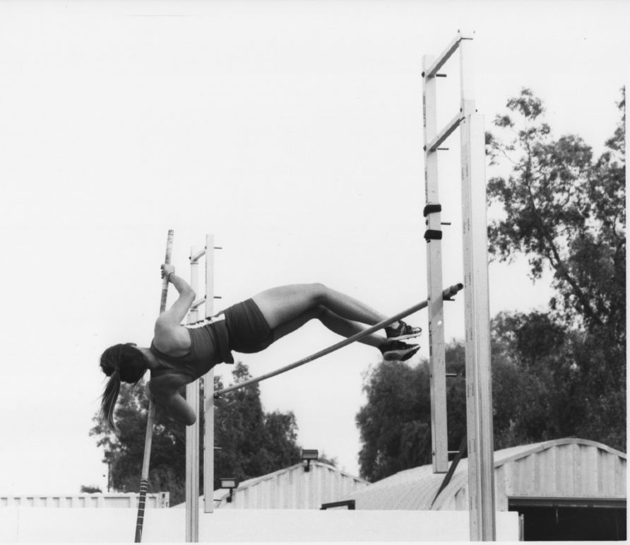

I use Wollensake 50, 75, 90 135 and 162, here are samples I printed yesterday, have not printed color, with B&W very nice lens. Kodak 4 and 5 element lens are very good as well.

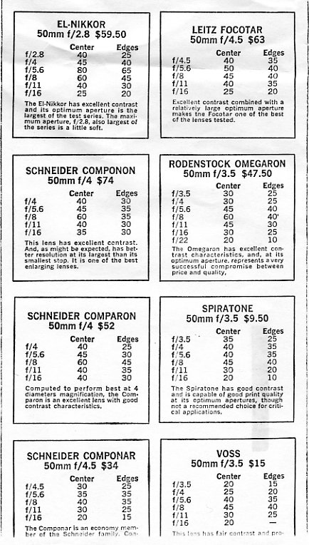

Here are the test results from a "vintage" photo magazine. View attachment 197989
I know the US "Spiratone" brand, their lenses are likely from Japan. I guess the "Voss" brand stands for a similar importer (Voss Photo Products).
The Spiratone and Voss branded lenses likely are plain triplets, as the Componar. It is interesting to learn about such great differences in image quality, especially as otherwise plain triplets do not show up at lens tests.
