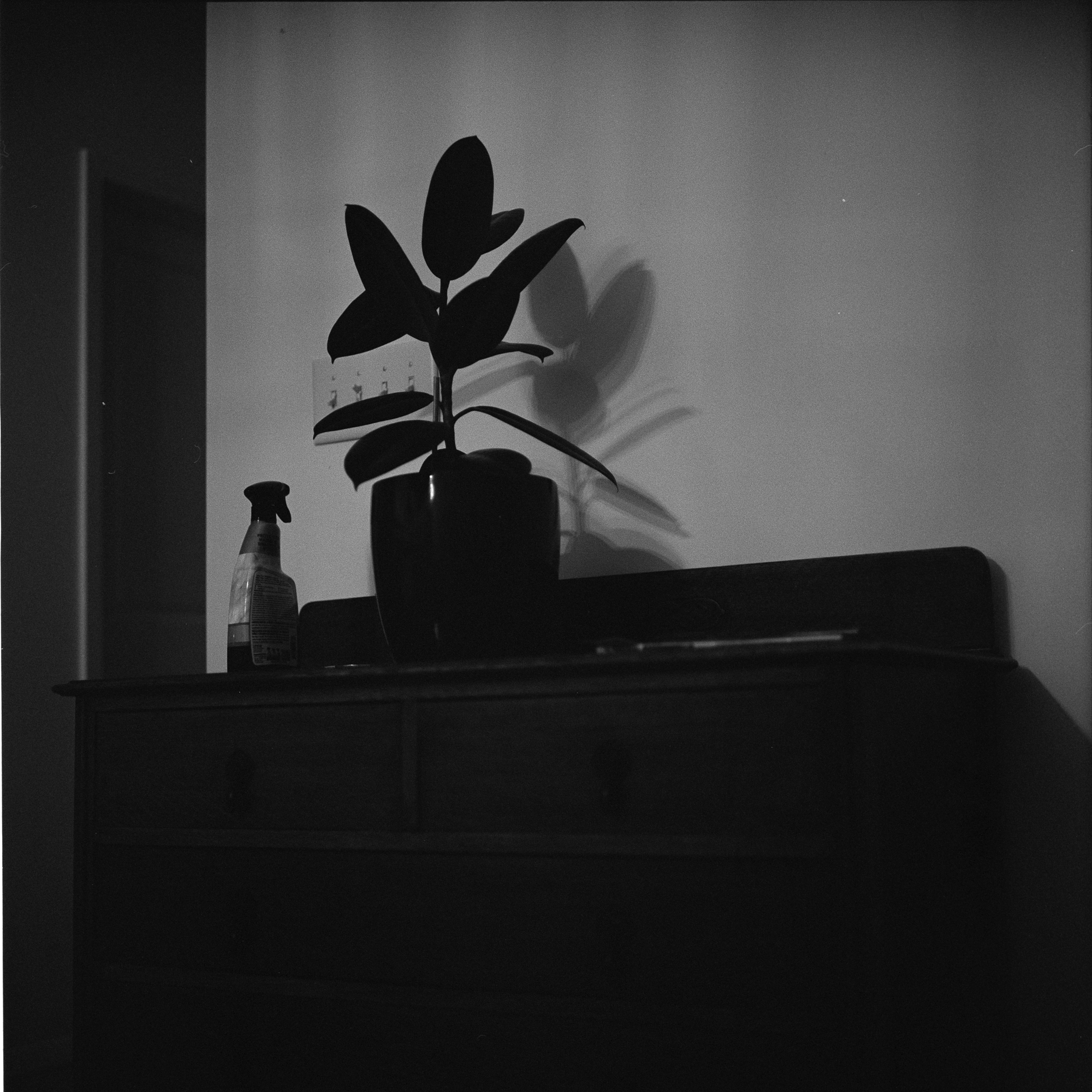

Sure. This is a significantly underexposed test shot just to highlight the problem (see unevenness on white wall behind the plant). Not sure if this is caused by developer surge, uneven development etc.
Process:
2 x 120 films in 1540 tank
Film is Tri-X
Rotary processed using JOBO SilverBase
Rodinal 1+25 to make 500 ml developer
5:24 minutes development @23.2 centigrade
1 minute Ilfostop
6 minute fix with TF-5 fixer
10 minute wash
Photo-Flo dunk
Left to dry overnight

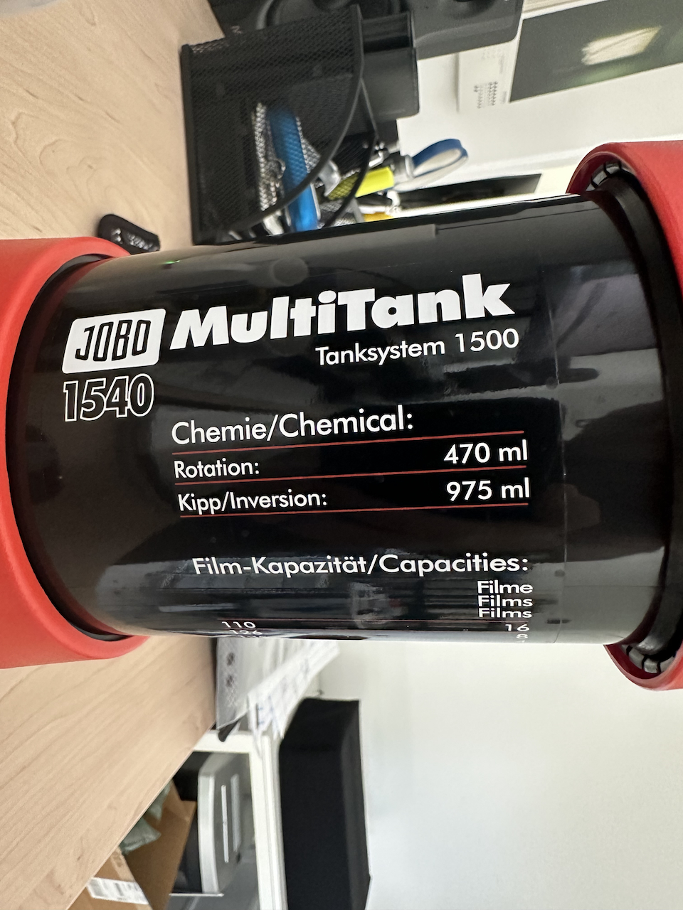

470ml is the minimum for the 1540 tank so I take it to 500 just to ensure cover

When I develop 2 120 films I use a single reel and a 1520 tank. My mistake. Of course you are using the correct volume. I've not had problems with the little Silverbase, easier than getting out my big Jobo. Not sure what is going on.

I would drop the temperature, increase the dilution and extend the time. The negative looks like it hasn't had time to develop evenly and working at a relatively high temperature this will exaggerate unevenness in highlights. You could also try pre-wetting the film although that depends on the film. The advantage of a JOBO is when you are using longer times anyway so just let it get on with it.

When I ran into unevenness problems with 120 film in Jobo 1520 tanks, I introduced a pre-soak. For me, this solved the problem. It's worth a try. Fill the tank with its normal processing volume of water, at normal process temperature, and let it rotate 2-3 minutes. I never found it to be necessary with 135. Only with 120 and also 4x5 in a 2500 tank.

Thank you yes this is good advice and why I think my Silvermax developments have been ok with the longer development times.
