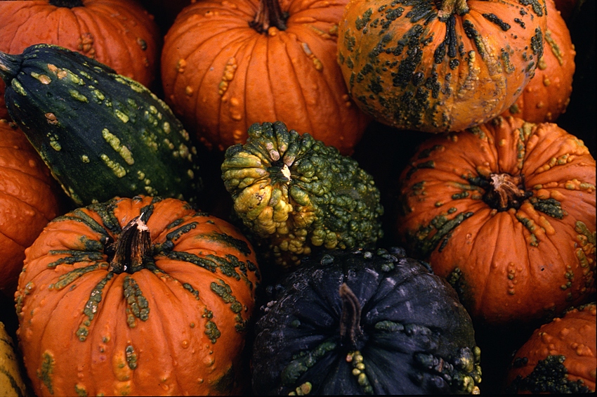

All exposed in light that would tend to favour a shift to the blue.

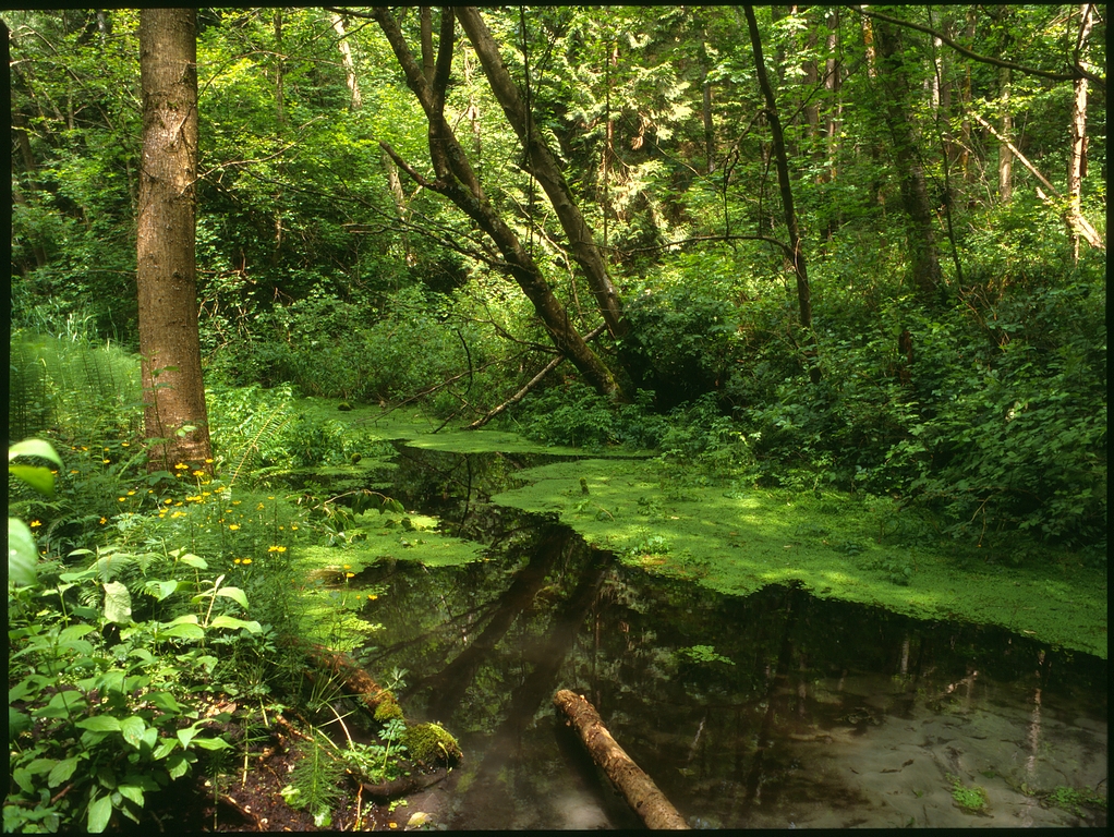

FWIW, these were shot on the pre-2012 Ektachrome - probably the GX version, because I too liked it.

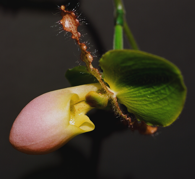

{Correction - there were initially two orchid pictures after this. The first orchid photo that was initially here was misidentified - a re-check of my notes makes me now think it was shot on Portra 160}

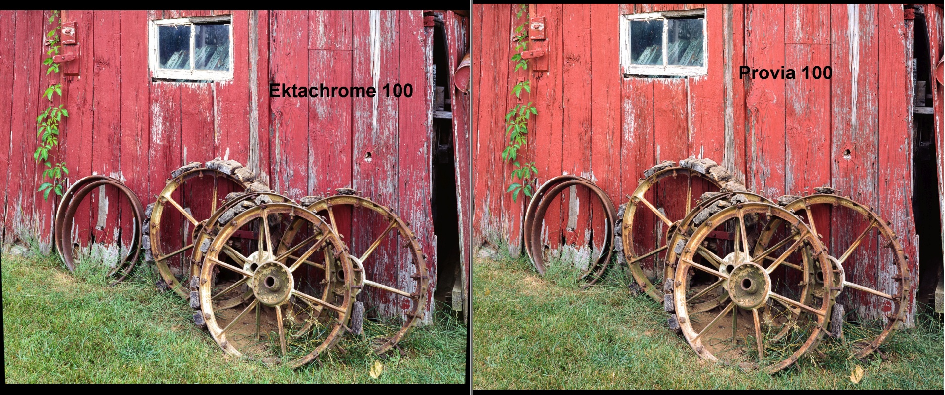

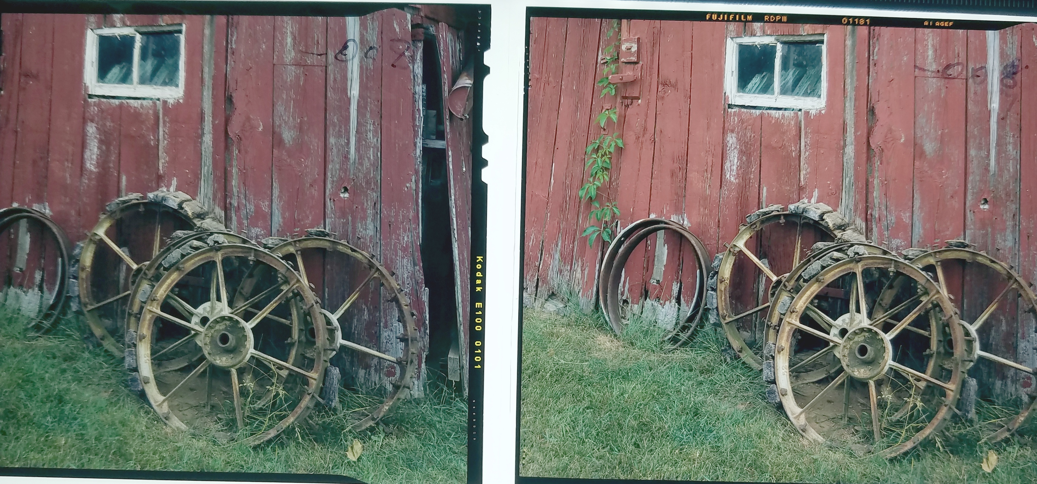

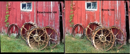

Here's a comparison I did between 4x5 Provia 100 and Ektachrome 100. Provia is warmer with orangy reds. Ektachrome has greener greens and redder reds.
The first is irignal film taken with a Galazy cellphone. The second is after adjustments in Lightroom after scanning with a Epson V850.
