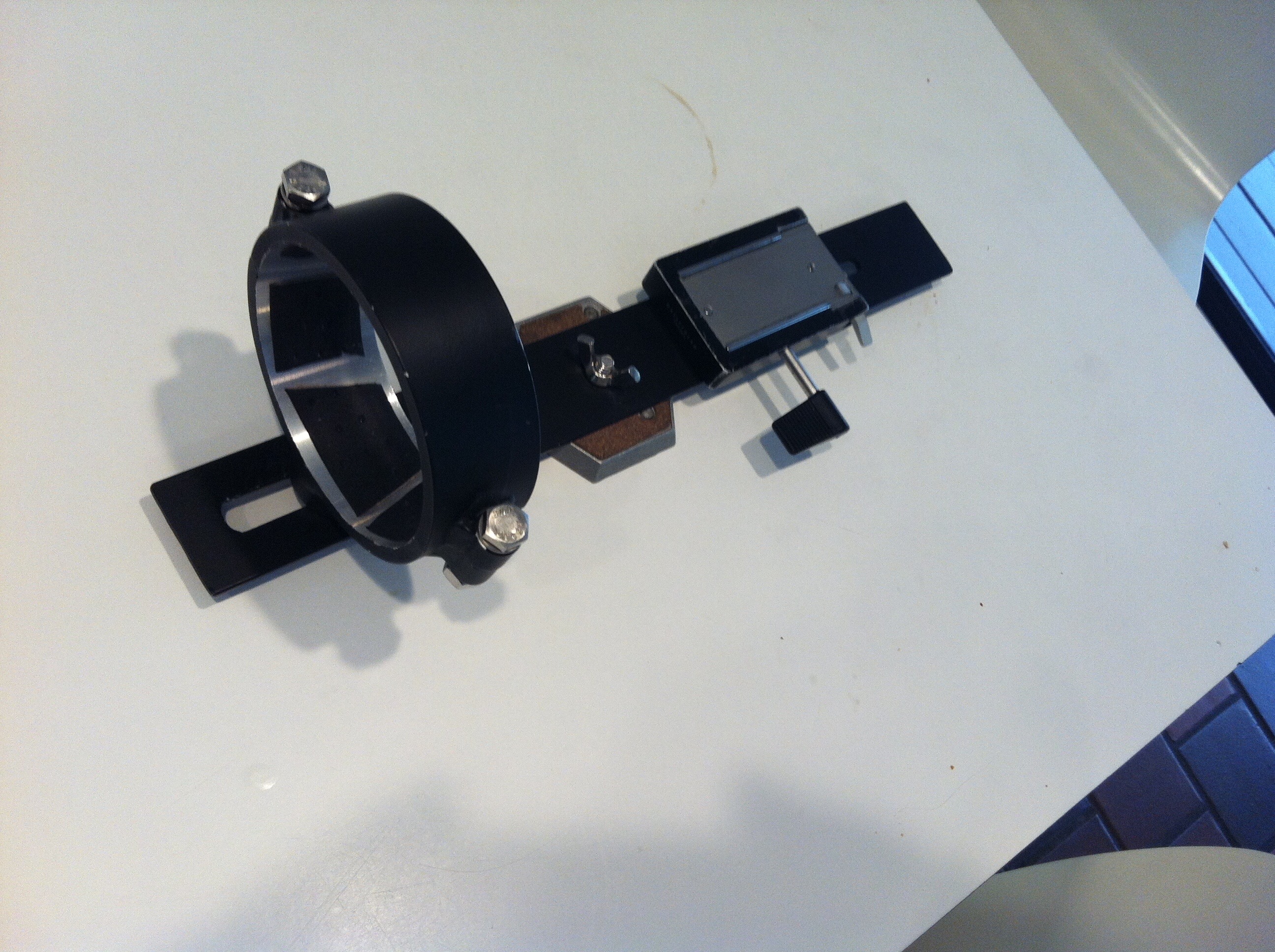

I designed my own and had a machine shop make it. It cost $60 and is very sturdy and adjustable
jeffreyg
Jun 12, 2008
2,643
florida
Here’s a picture of it
Jeffrey, what a super solution! Are you using it with a 350 CF? Would you be willing to share the design docs? I have a Really Right Stuff Arca Swiss style plate secured to the base of my 501CM to allow my RRS BH-55 ball head to be used. 🤔. I will be making mine in oak (heavy but strong) since building furniture is another passion (photography, music, and wood working keep me away from the TV 😆). I will post images when it comes to the front of the project queue.

Bill I posted a picture on the page above. It is a simple design An aluminum bar with slots to hold a tripod quick connect and the Hasselblad quick connect. Also the two piece collar that the machine shop made to exactly fit the lens barrel which is adjustable as held to the bar incase I want to use a tele extender. The upper and lower parts of the collar are connected to each other with nuts and bolts that can be hand tightened The lower collar part has a threaded screw permanently attached that fits through a slot and is tightened with a wing nut. All the parts can be disassembled if desired to take up less space in a camera bag or used with a different tripod. You could also have different collars for different lenses. Any decent machine shop should be able to make it. I did this some years ago and at that time they charged $60.

Just to add my 350 has a tapered barrel so they had to match the collar to it.

Jeffreyg, your earlier image got my brain working, and I was about to make one of oak and some RRS components.
