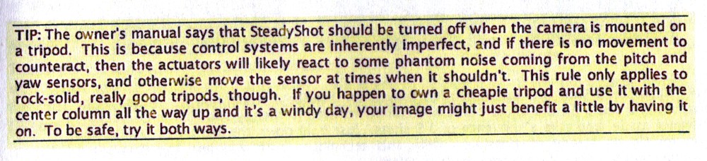

The longest lens I shoot with on my Digital Sony A mounts is 600, sometimes with a 1.4 tele converter. Sony A mount has VR built in, I use a Quick Grip Husky tripod and the longest exposure I can go without some level of vibration is 1/15. If shooting film with the same lens and tripod with a Minolta 9, not slower than 1/60th. With digital I bump the ISO up to 1600 or set the shutter to the lowest I dare, the aperture I want and let the ISO go on auto and hope for the best. With a long lens at any distance atomsperhic distortion, heated air, dust, pollution all take a toll on shaprness. I consdier the 600 to a lens of last resort, more often then not its a 300 or 400.

Here's what Gart Friedman has to say regarding the Sony SteadyShot in his Sony 900/850 book:
I've read that VR is best in the lens, not in the camera.
That is what I understand and why Sony dropped VR from the body and put in the lens with E mount, but as I understand it Nikon uses in the body VR with their Z mount.
I've also read that if IS in ON in the body and ON in the lens at the same time, bad things can happen. Not a problem for me -- even if there is some truth to it
That depends on the system. My Pentax has in body shake reduction & I have one lens for it the has OS, but neither is aware of the other, so both on is much the same as neither on. Any movement is canceled by one & then introduced in the opposite direction by the other.
More modern systems can have the two systems working together to give better stabilization than either along. I think Olympus was the first to offer a dual stabilization system, though others have since followed.
It’s not with Olympus, it’s one of their strong points. When you switch on IS on the lens, it automatically switches on IS in the body.
on the other hand, using IS while the camera is on a tripod, seems to be a bad idea.
