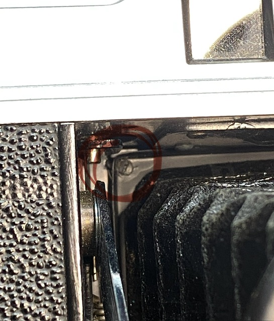

Taking a new look now with a flashlight I guess the bellows are clamped into a frame and the frame is screwed from the front. I can see 4 screws (painted black, hard to see) on each corner of that frame. Having the lens attached into the camera doesn’t allow me to see further but I would try those 4 screws. Put drops of acetone on each screw because they seem to me very easily to brake.
Attached one photo of one corner.
I hope this helps.

Thanks for your reply. There are actually 8 screws: in the corners and in the middle of each side. But to unscrew them and screw them back on with the new bellows is really difficult without removing the front flap. So the big problem is how to remove the front flap?
I shave actually managed to unscrew all the small screws with the front flap on, but there is no way to get the plate out of the camera even with the bellows removed. At least none that I can find, without unscrewing the front flap. And as I mentioned, I think the front flap is being held by screws whose heads are accessible from the back of the camera at the very bottom where the film spools lie. But they are at such a weird angle that I don't get how you are supposed to unscrew them.

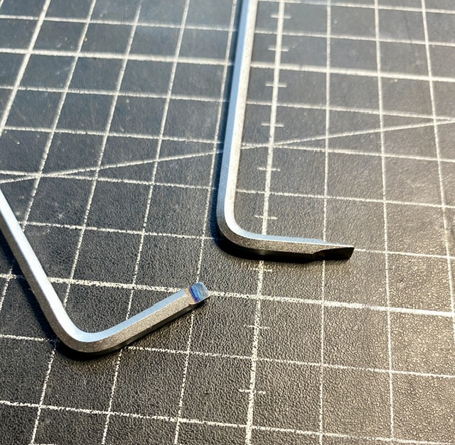

You need these wrenches
I made them from usual hex wrenches and they are very handy for this kind of job, mines here need to be shortened because they don’t fit into the film chamber.

Thanks a lot! I‘ll try it out. I‘ve tried a couple of things with a lot of force but no effect. Hope I haven‘t damaged the screw heads too much. In your experience do they turn the regular way (opposite clock direction) to unscrew?
Many thanks! I‘ll try it out and report the results.
To give an update, I made the tools that you showed, but had to additionally make two in 45° angles. I made it using a Dremel-like device on Allen wrenches from IKEA. Overall, it was really really difficult to unscrew the screws (the ones holding the flap as hindges). You only need to unscrew them about 3 mm on each side, but I didn't know, so I unscrewed them completely , because the flap is sitting quite tight. It took a really long time and I was at some points about to give up and just sell it as defunct on eBay :smile:
The screws are made of aluminum I think and the heads deform easily. They must definitely have some type of anaerobic thread lock because there were residues on the screws when I unscrewed them.

I‘ve tried several different tools, and the only thing that worked were such selfmade wrenches as on Alex Varas‘ picture above. You need one for every 45 degree angle (4 in total) and they need to be really short. What helped was to fit them into a 1/4 bit screwdriver , so basically you get a screwdriver handle with such a wrench as a bit.
As I said you only need to unscrew about 3mm on each side. Worked best for me with the flap open. Then you can take the flap out of the hinges. The rest is easy. Be careful with that metal rod that sets the rangefinder.
