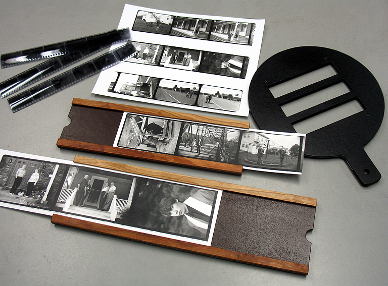

I'm mostly a medium format and large format guy.
But every once in a while my Nikon comes into play and I want proofs that are big enough to actually see.
Back in 1990 I made a carrier for my 4x5 Beseler to enlarge 3 strip of 3 negatives onto a sheet of 8x10 paper.
I resurrected the idea, and put the Mark II version in the classified section.
Take a look...
Reinhold
www.Re-inventedPhotoEquip.com
www.classicBWphoto.com

removed account4
Jun 21, 2003
29,810
that is the coolest !
and your viewing things are beautiful enough to use as a frame :smile:
john
ps. great website with your reinvented "stuff"
