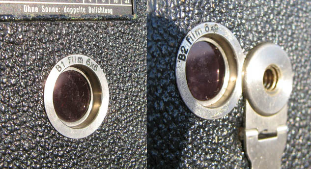

The original Rolleiflex used 117-film and the red window was used for each frame. Then the Rolleiflex Standard came on the market, and in the beginning it had two red windows, one on the back for 117-film (B1) and one on the bottom for 120-film (B2) And this was because of the 120-film only had the 6x9 numbers on the backing paper.

Yes, 117. Long-obsolete formats are hard to keep track of.
So that Rolleiflex Standard had a frame counter, but it could be started with either the 6x9 or 6x6 track (if present), else why not just specify 117 only (yes, 120 is longer, but you'd still only get 8 frames using the red window).
The red windows on most of these Rolleiflex Standards were marked, but on some they were not.
On this camera the covers had been lost, as they normally are. Later they got rid of the 117 (B1) window and added a sliding cover for the 120 (B2) window.
