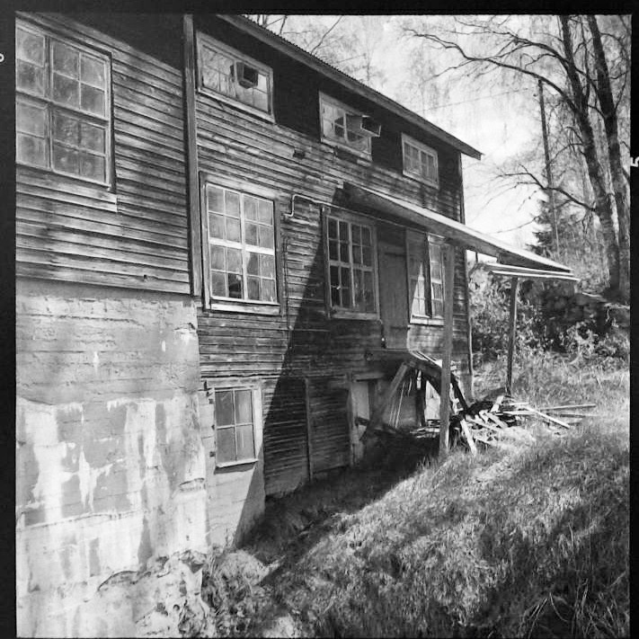

I like to use Adox clear film sleeves because making contact sheets in darkroom is pretty easy and I think the quality is totally fine - for a contact sheet.
However making contact sheet might sometimes be extra work and altough it is nice to hold the paper and keep nose on the paper looking at the sheet, the digital version is always tempting. Easy to zoom in, easy to crop, try some rough tonality changes etc.
Today I developed batch of film and was about to go to darkroom to do contact sheets. But then I just started to wonder what would a digital photograph of the contact sheets look. So I laid the sheet on light table and tookshots with just a kit lens (no macro, no multiple exposures, just handheld one shot) and went on computer to have a look. I used Fujifilm X-T30 and XF 18-55 "kit" lens.
I was amazed how good the quality was. Yes I was photographing 120 film but I will probably do this on 135 film also. Probably in a way to see which frames are worth scanning properly or making a work print. Should work for that purpose even on 135 film.
Maybe this is a no-brainer to others but I was just amazed how usable the shots were. More than expected and far more.
TL;DR: Take a digital photograph on film in clear negative sleeve on a light table and be amazed.
Here is a overall shot and one frame cropped from the same photo:
.. and also praise to TLR cameras; no need to rotate the contact sheet like a wheel of a rally driver :smile:
