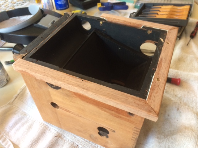

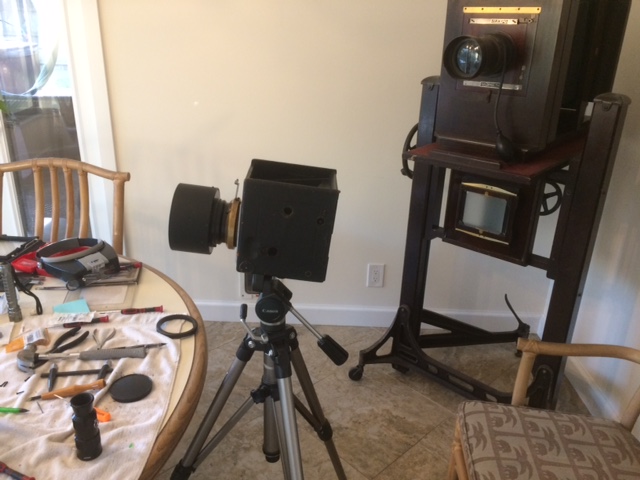

I'm right in the middle of fitting an 178mm AE to a 3x4 Super D. Has anyone tried this?
Yesterday I successfully bored out the inside of the camera to make room for the lens and tilts. My first lens board is very close to being like it should be but I will have make another with the hole a touch lower to better clear the mirror. John Minnicks has successfully altered the mirror to allow it to swing even at infinity, but as a portrait photographer I'm very tempted to leave that part alone and simply use the GG if I need to shoot at infinity. I may however need to find a way to prevent the mirror from crashing into the lens if I happen to be to close? Maybe a simple indicator could work? Any opinion on this?
I've been tearing down Speed Graphics and putting them back together successfully for a long time but this thing is way way more complicated.

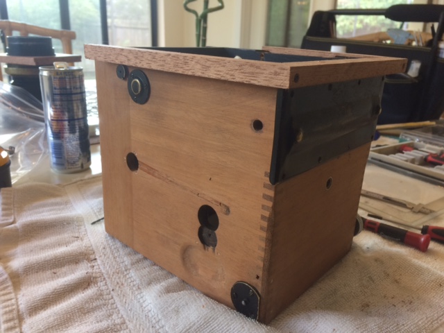

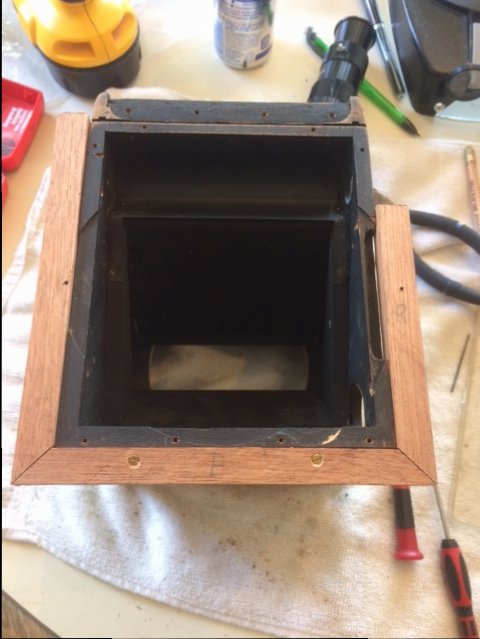

My Super D is a 3x4. I took everything off of it except the mirror because it looked like I would damage some of the glued in light seals if I did. After reading your reply Ed about altering the mirror I may reconsider. I would not mind at all if I had to use the dark slide to change shutter speeds, really small price to pay to get the mirror to work at infinity. I will probably start by checking to see just how low I can get the lens mounted in the lens board and still get good coverage on the GG. The mirror I have is in great shape so I may be able to remove it and grind it down carefully.
As for tilt I expect that part to be easy because all I have to do is add clamping knobs to the center of either side of my wood lens board. I don't care so much about the swings for the same exact reasons that you mentioned, however you make a great point about getting focus on both eyes on an angle. One thing I am a little worried about is shooting without a loupe, I shoot art nudes all the time with a Speed G and I always rely on the loupe for spot on focus. My Super D has a perfect hood, including perfect frissies, so it would seem that my eyes will be kinda far from the GG. Maybe I can rig up a flip up loupe like in a Rolleiflex somehow.
If you do decide on the tilts and swings hogging out the inside was no problem, I used a 4'' hole saw bit in a drill press. It took out as much as possible without cutting out the space for the bellows to mount to. The next move after I work out the mirror issue is to peel the leather off and glue in more mahogany on the back to mount the graflock back on to Minnicks style. I guess I will use a grinder to take the bottom portion of the Graflock down.

The mirror is relatively easy to disconnect. Yes you have to disconnect some light seal at the top of the mirror frame but it can be done without destroying the light seal. The view hood and ground glass have to be removed or the focal plane shutter and image box sides have to be removed. The image box side are attached to the body with wood screws and are what the mirror frame rest against when in the set/view position.
The mirror itself can be removed from the mirror frame by removing the 4 screws on the back side of the mirror frame. There is felt glued down on each side of the mirror that should come off easily.
There are 3 screws at the top edge of the mirror frame that hold it to the mirror shaft, they can be difficult to remove. The mirror return spring is housed in the brass cap on the left side and is held by 3 screws. Remove 2 of the screws, hold the cap with a spanner or similar via the empty screw holes, remove the 3rd screw, release the spring tension, and pull the cap off. The mirror return spring will only work correctly installed one way, it will go in 4 ways, 2 slots in the cap, 2 spring ends. Once the screws are removed from the shaft and the return spring is removed pull the shaft from the body and remove the mirror frame from the body.

Thanks, I got the mirror and assembly out with no problem.
That stand really is fantastic, it moves the camera any way you want like it was weightless.

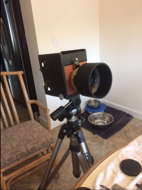

I decided to stick with landscape for the graflok, could be that I'm being fooled somehow but the entire ground glass is well covered by this lens. This may not be the case when I build the new lens board with a recess in it to get the Len close enough for infinity. Anyway here are a few pics I took right after I glued up th new mahogany to mount the back onto.

The body covering thickness was calculated in for all the components in the camera. The roller bushings, mirror spring cap, wind plate, tension plate, focus shaft plates, release plate will need to be shimmed out from the bare body the thickness of the original body covering.

shutterfinger nailed it on the thickness needing accounting for. I ran into that with my Woodie version I am working on. Definitely needs attention, especially the caps that are the bearings/bushings for the rollers and all the others he mentions. I used washers in most of these places.
Landscape mounting of the back will give a 4x4" image. remember, 4" was the long dimension on the 3x4 camera but the short dimension on the 4x5 camera. putting the 5" horizontal on the 3x4 is going to limit it to the 4" width, where putting it vertical gets you the extra half inch or so.
