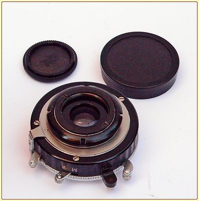

I think I just found one reasonably priced on eBay actually although I'm worried about rear elements,
Is this missing rear elements or is that just a spot to screw in a back cap?
Neil Poulsen
May 28, 2005
525
Personally, I wouldn't bother with the 65mm f8. I used one of these for 6x9. Get what you want, the f5.6 version. Watch for prices; you might be able to find one for around $450. I see them occasionally for that price, but not much lower.
